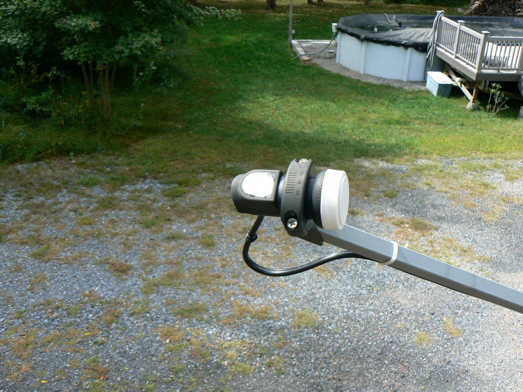

Post some pictures of your current setup so we have a starting point. We always like pictures... worth a thousand words they say... :)
Here's what I have "Patriot 36x31" Offset Ku Dish with Avenger 0.2dB NF Universal Single Ku LNB." Would a LNB with no feedhorn even work?

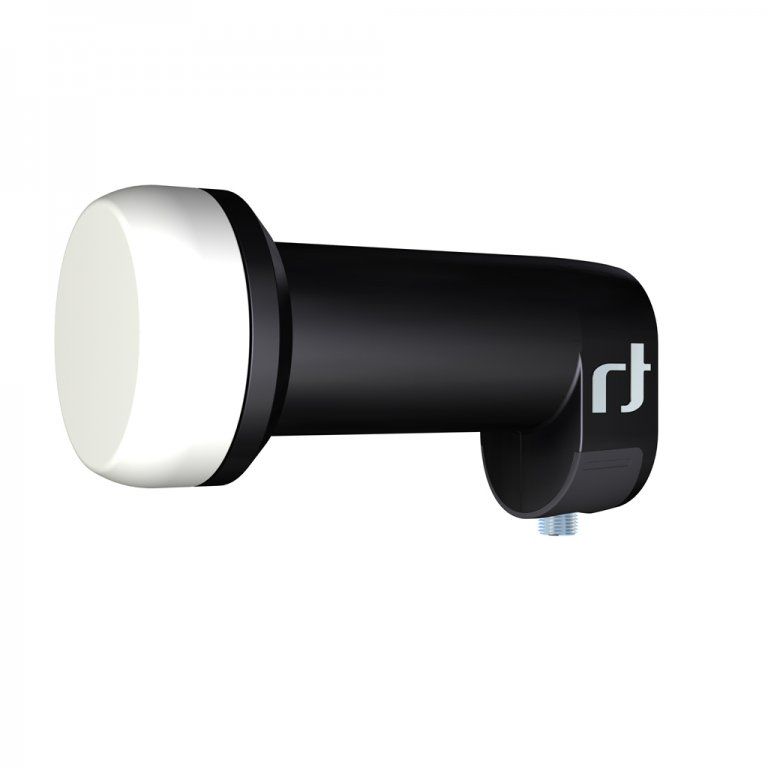

Here (other side of the pond) one of the best performers is Inverto Black Ultra or IBU. It has integrated feedhorn and called an LNB, even company than produces it, calls it LNB. But to not confuse public there is picture of this LNB. Price is about 15 ish.
Just because Inverto incorrectly calls it a LNB, doesn't make it so.... Yes, it is an LNB, but also has an integrated feedhorn/scalar. The rest of the industry calls it a LNBF. :D

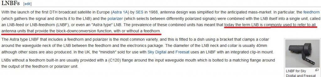

OK, it is understandable difference, I am not arguing. BTW, in Wiki we also can find explanation like this: ScreenHunter_482 Sep. 22 20.53.jpg
