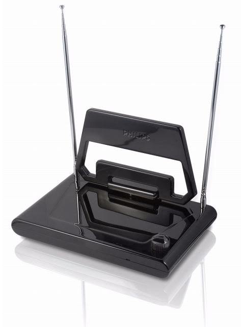

This is my indoor antenna. It's a Philips, not very fancy, but it worked. There is a tuning knob on it that I would turn to get a better signal.

Also be sure to check if the channels in your area are uhf or vhf.Could actually be both although most now broadcast on uhf.Some antennas are vhf only and that would explain why you don't get some of your locals.That said an outdoor uhf/vhf combo antenna will beat any indoor antenna.I'm guessing you get Nashville TN locals.Looking at the list at rabbitears.info I see that at least 3 of them are on VHF the rest are all UHF.
