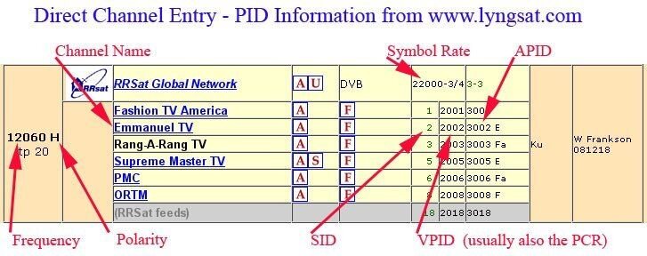

SatelliteAV SatelliteGuys Master Lifetime Supporter Sep 3, 2004 6,486 186 Roseville, CA Feb 1, 2009 #3 Here is a quick tutorial on identifying the channel programming information from website LyngSat - Lyngemark Satellite Go to www.lyngsat.com Select the link under Frequencies / America Select Satellite Galaxy 19 @ 97W Scroll down to the KU-band frequencies (10750 - 12200) See attached JPEG indentifying the necessary information Cornerstone (CTVN) channel is a bit unique as the PCR does not use the VPID. CTVN PCR is 4132 Attachments Lyngsat-PID.jpg 45.4 KB · Views: 316 Last edited: Feb 1, 2009

M Mr Tony SatelliteGuys Pro Supporting Founder Nov 17, 2003 4,430 18,226 Mankato, MN Feb 1, 2009 #4 just scan 12115 transponder. Its there and should log in just fine
Y yeoldgrouch Member Original poster Feb 1, 2009 7 0 East Texas Feb 1, 2009 #5 Thanks to yhose who helped with PID's The help you all gave solved my problems. Thanks yeoldgrouch
