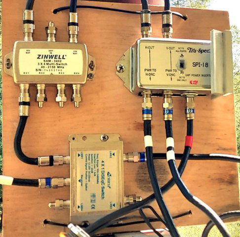

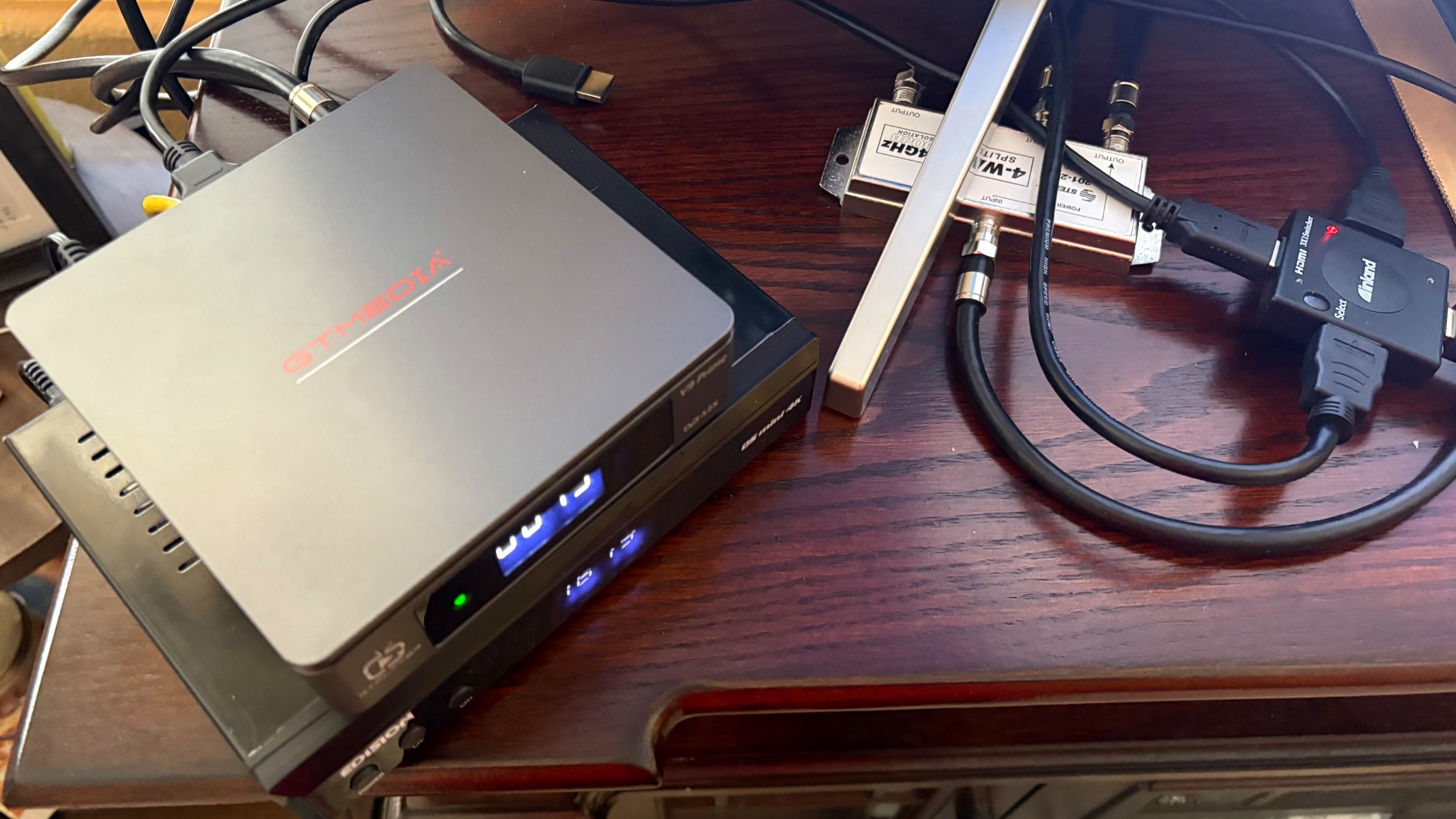

Ordered this as a temporary solution. Should split the LNB signal to all 3 receivers. Power pass on just a single output. One receiver will be the "master" and provide LNB power and blind scan capability. The "slave" receivers will be able to access the H or V polarity based on what the "master" is tuned to.
