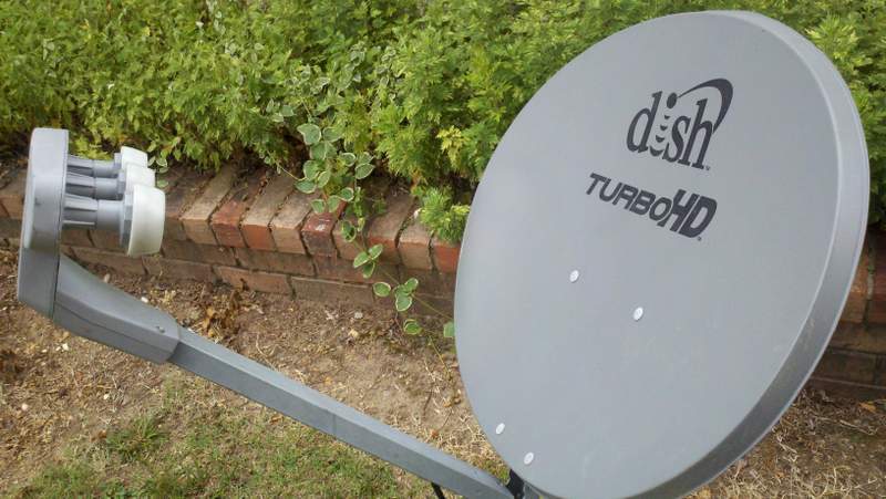

Here is a pic of my dish. I believe it's a 1000.4 WA, right?
The first 1000.4 dishes they put out had the grey reflectors. That meter will probably just not be able to tune in that dish. It is very difficult to tune in any 1000.4 ea or wa with anything but a super sat buddy. Your best bet short of spending the $700 or so would be to do it old school and use the signal Meyer on the dish using port 1 on the lab and setting the signal screen at 119
Do you know if I can use a Accutrac III+ or a FirstStrike FS1 for a dish 1000.2/1000.4?
Don't know about those two meters as I use a birdog, but I can tell you that is definitely a 1000.4. Notice the coax exiting the feed arm on the bottom? That's .4, .2 exits at the end of the feed arm. Either dish can be got with either color reflector.
