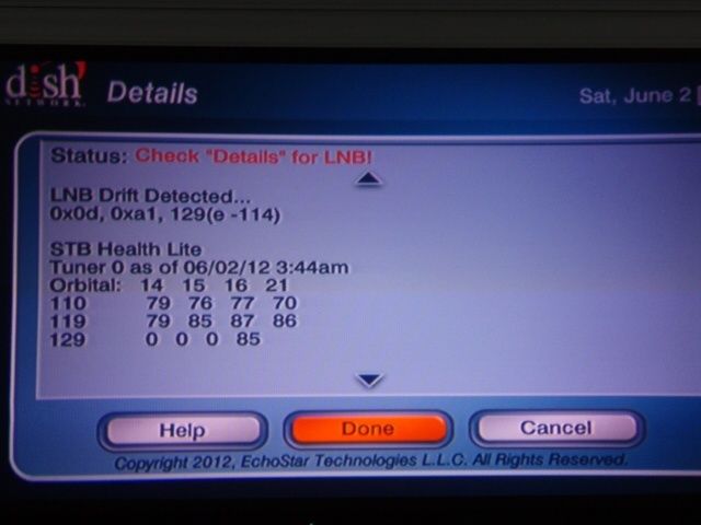

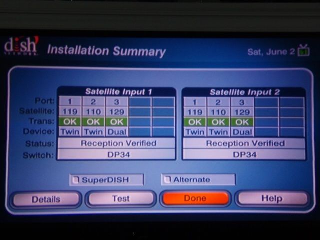

I am stumped. I upgraded 2 receivers back on 3/17/12 and all was fine. This past Wednesday 5/30/12 I lost SOME not all HD channels, on Sat 129 and on the new receivers. The older VIP622 (10/2008) gets the channels although it takes a little longer than normal. All receivers were check switched and disconnected and restarted.
Here are the technicals as pictured from the VIP722. Thanks for all the help in advance. :confused:
it might be a bad switch
if you don't want to have a tech out, you could test it by bypassing the switch and run 129 straight to the 722
you could also change the outputs of your switches or swap the rec locations
