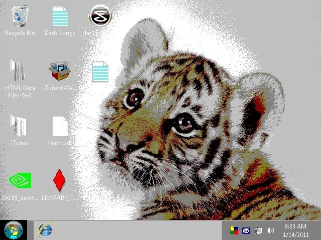

I just bought a new Video card. I am no dummy when it comes to this stuff and I cannot figure it out..I must confess, I have always used AGP, this is my first PC Express card. That being said I got it hooked up, installed, proper drivers, etc.etc. All I see is a big 800x640 screen all jacked up in different colors..I figured bad driver..Nope replaced it, and still the same. Now this is a DVI card, dual as a matter of fact..I have the DVI to VGA adapter..The only thing I have not tried is the DVI to vga adapter on the monitor..I cannot do that until tomorrow this monitor doesnt support DVI, just VGA..Is that the problem? If I am using DVI to vga out of the card does it have to be the same on the monitor?

This is waht i see with it.
Only thing I can think of is that the wrong driver is installed. There are a lot of variations of cards, and some of the nvidia downloaded drivers cover some but not all of a similar model number, maybe clicked on wrong one in the drop down list and got the wrong one?
Is it just detecting the monitor's resolution wrong, or does the display look like that even if you set a sensible resolution and depth in the control panel?

The card was bad. I know this because I bought another one. Not the exact model but another nvidia card. It works fine I've sent the other one back to tiger direct. I am and always have been an nvidia guy so ati was out of the question. As for the motherboard it's a new system I put together. All is good now

Your screenshot shows a 16-color (4-bit) screen. Since you've already replaced the card, it's a moot point trying to troubleshoot now, but what you saw usually indicates the wrong driver for the card. Even Windows couldn't find a SVGA mode that worked.
