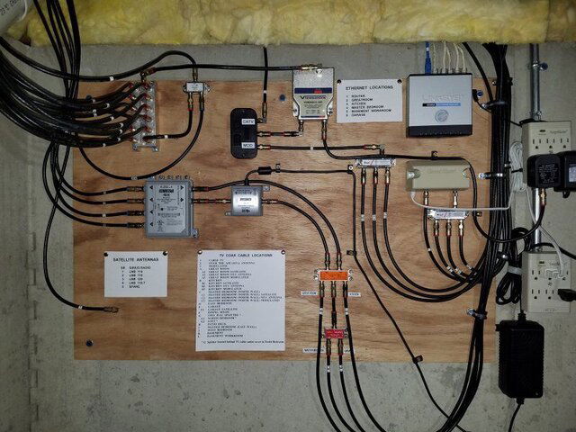

I have two Hopper 3s, two 4k Joeys, and two Wireless Joeys. Also have a RF Modulator attached to each Hopper. Both Hoppers send TV signal to a 12 port home distribution splitter. Presently I have 11 active TVs. Attached is a diagram and pic of my home distribution system.

Stop and think !!!!!!!!!!!!!!!!! He already has SD on the 722/722K why wouldn't he be happy saving money on Hopper with a modulator?
