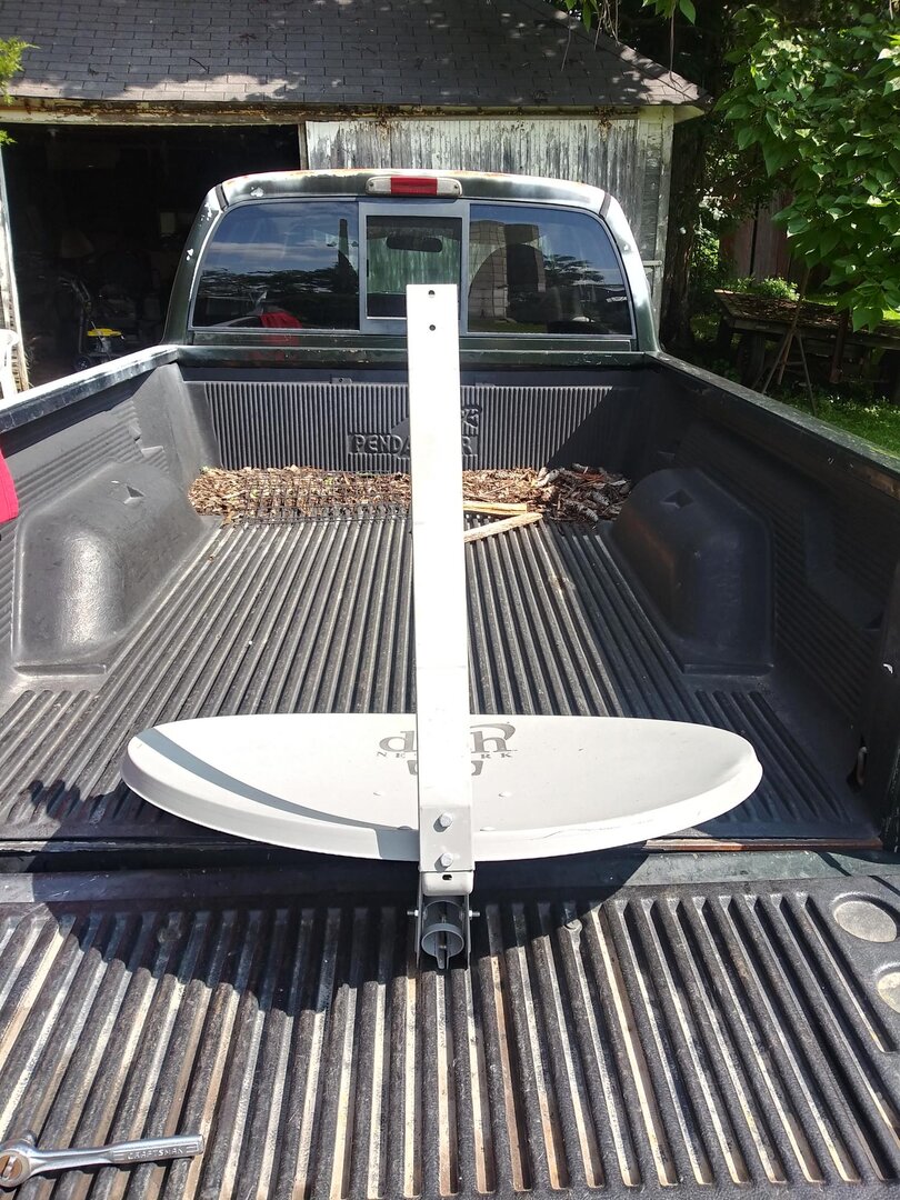

So here is what the LNB arm looks like, don't think it's supposed to lean like that. Gonna see if I can straighten it as I don't think it's aimed very well at the sats huh??
Well here's my day. I did my best to straighten the LNB arm, used a square to make it extend 90 degrees from the dish. Installed the LNB assembly again with the 129 side dish and mounted on my tripod. Set it up next to my present setup, leveled and set elevation and skew. Got my monitor and VIP-211K going and did a check switch twice and got no signal. Come on man what the heck!!! I have a small inline signal meter to get it close. It was time for dinner so I shut everything down wondering what to do next. Seeing as tho it's next to my setup I can compare azimuth and sure looked very similar. So after dinner I go back and figure let me adjust a few things, so I change the elevation up slowly and my signal meter starts really churping. And then before even doing another check switch my signal on the VIP showed up for 119. Well now we're talking so I did the check switch and now have 110, 118, 119, 129 finally!!! After some finer tuning I had a decent signal on all, 129 improved my signal for sure. Now I know this works, gonna try this setup out where I think I have a better view. But may just put this on my present pole and see what happens. I know it will be easier to fine tune as the pole is solid and my tripod is pretty solid but does move. So there you go, persistence has paid off, was close to packing it up and giving up.....thanks for all who have given advice and kept me going. I'll LYK after I get this setup more permanently..

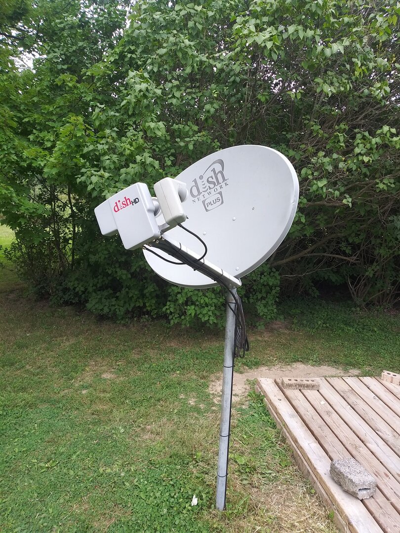

So had a few other projects going on, and honestly dreading continuing this upgrade, I got back to it yesterday. I did one check of the 1000+ on my antenna pole and got all 4 sats so decided to proceed. I removed the existing 1000.2 and replaced with the 1000+ then aimed, got a signal on 119 and tweaked things for the best signal. Then did a check switch and only got 3 sats, minus 129. Did a few more things and still only 3 sats. Replaced the single LNB in case it quit working and only 3 sats. Played around with it for abit then gave up and put the 1000.2 back on. Figured I would give it a go one more time today, setup the 1000+ on the antenna pole right next to existing and only got 3 sats again. I just about gave up and left it for lunch giving it some thought. I remember someone, maybe on this thread, saying it helps to do a check switch with no cable attached so I said what can it hurt! Left it figuring it was gonna take awhile and came back no sats. So I realigned to get 119 and peaked the signal. I did another check switch and I'll be darned got all 4 sats. I dont know if just aligned it better or doing the check switch cleared everything and helped. So I figured I would replace the 1000.2 again while it was working and started getting good signal right away. I never did another check switch as the 4 sats were still in memory, so I tweaked with a pretty decent signal on all 4 sats and tightened down. I then went inside and check switch my VIP-211K, grabbed all 4 sats , did the guide and we are good. Will see how it goes next rain....

It never ends, discovered not getting an HD picture on some channels, only getting a signal on the odd transponders. Did everything I could think of and not a budge for the evens. So took it back off and put the 1000.2 back on and it gets odd and even. So cabling is not the issue as the same cable was attached to both dishes. Only thing I can think of is the LNB isnt switching internally. Also thought I will try the other 2 outputs on the 500+ LNB, only tried #1 so far. Is it possible to get a great signal on the odd transponders and nothing on the evens with alignment? I peaked for the best signal, I know the evens may not be as strong but 0 signal doesnt cut it!! I have to setup my temp pole again, not sure if 129 is the only problem or all 4 sats.
