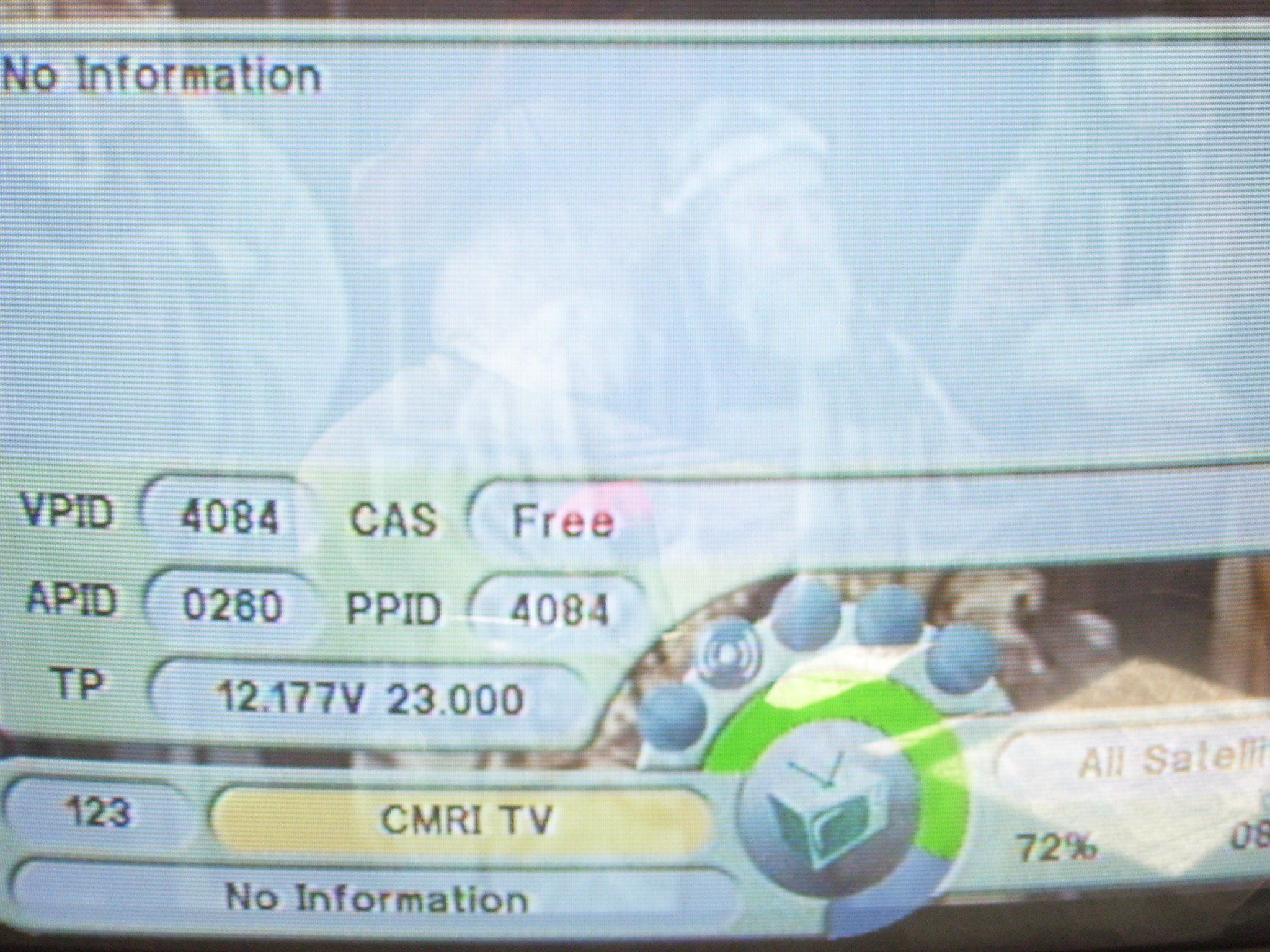

logs here fine. Just scanned it in. Did a manual scan (transponder scan)
shows as "CMRI TV"

Thanks for the screen shot of CMRI.
I had blind scanned, and didn't receive CMRI, I tried auto scan no dice on the Viewsat. I had to manually put in the VPID, APID and PPID to receive it on the Viewsat and it gets it fine now.
