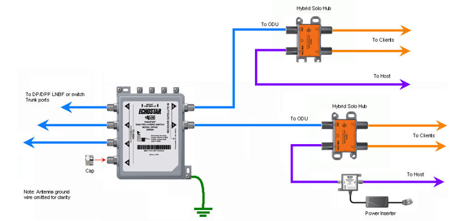

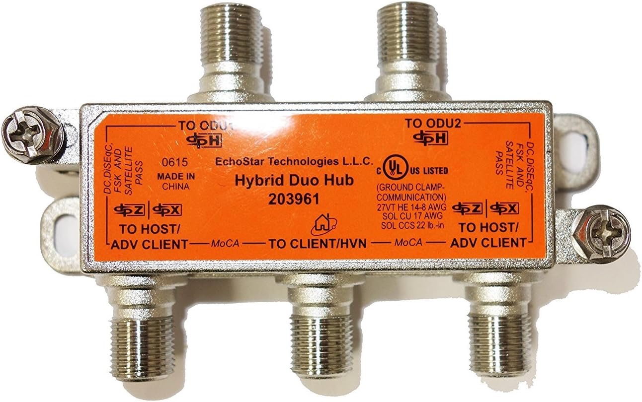

Two hopper3s need a dpp lnb with 42 switch and two solo hubs. While not approved you can technically run a jumper from client on one hub to client on second hub and then the two hoppers will see each other.
You technically can but it's not the proper way to install two hopper3s
But we have a few here who have the Duo Hub configuration working for years without issue. That jumper you mentioned also works but also is not approved. So you can buy 2 solo hubs and place a jumper between them or buy 1 duo hub and be done with it.
So it appears as though if the 42 switch is installed outside in the box, I would need a separate RG6 to each solo hub in the basement?
