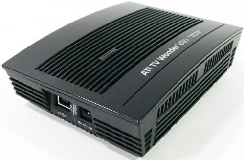

Hauppauge with their WinTV and AMD/ATI TV Wonder are the major players for tv tuners for computers and Hauppauge seems to be the choice as the AMD/ATI TV Wonder 650 USB is really big. Smaller devices because of chassis size always has more heat as long as the heat is properly released with a heatsink, it's similar to the new DOCSIS 3.1 cable modems running the exact same chipset, the Arris SB8200 is hotter than the Motorola (made by Zoom) MB8600.
TVW650USB - ATI AMD TV Wonder HD 650 Combo USB
