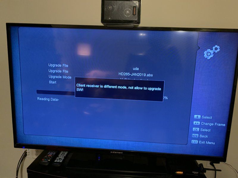

I get this message when trying to update it:
Did you see THIS above: "I will also mention here again, make sure when you upgrade, you select ALL PLUS BOOTLOADER!!"
Reread Mike's post above ^^^
Hmm that is odd. Let me get up with you tomorrow David.

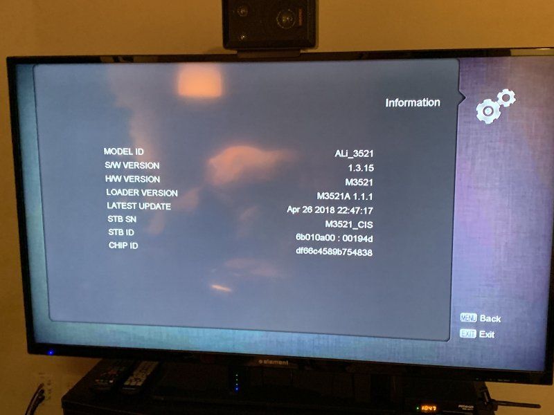

Try the attached file first David, then go to the new one. You running the initial NA firmware.
