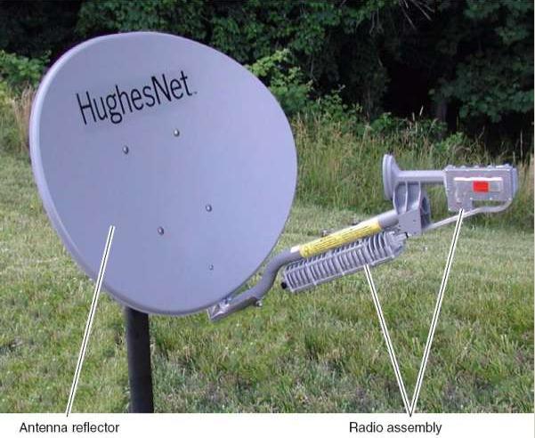

Is this the dish?
mikeroberson2006
Jan 27, 2007
69
Yeah thats it. Yesterday i figured a way around it. I took the nuts off of the azimuth bolts and switched them for other nuts/lock washers in the bolt pack, much easier now.
