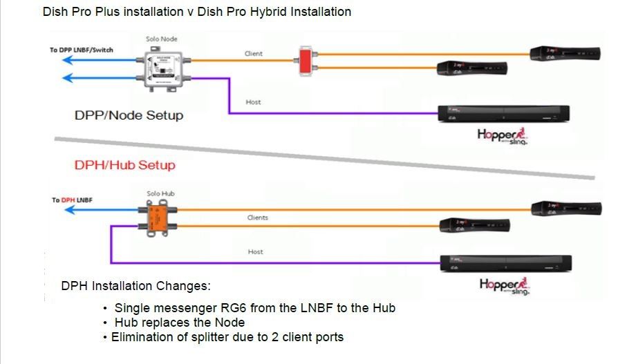

Also answered is the question about what to do in a hopper only (no joey) install, and that still requires a hub. And in terms of the Traveller, I would almost guarantee that this isn't compatible with it just based on the fact that the Traveller is going to be speaking DPP to the LNB, and this thing obviously doesn't speak DPP, but instead expects to communicate with a Hopper as if there's a Node there.

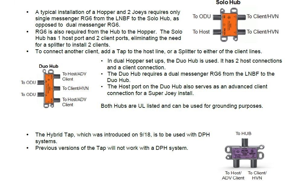

On the face of it, it seems like it's not adding any additional capacity, since there is a "Duo Hub" for 2nd Hoppers and Super Joeys, although that could be due to limitations in the tuners in current generation Hoppers/Super Joeys.
The fact that a hub is required even on single receiver installations, though, points to the need for them to block MoCA from going up the line, which could signal that they've stacked even more orbital slots to higher and lower frequency ranges. So, it's possible.

The only benefit I can see so far is 1 less wire from the dish. This isn't a setup for a 3+ hopper system.

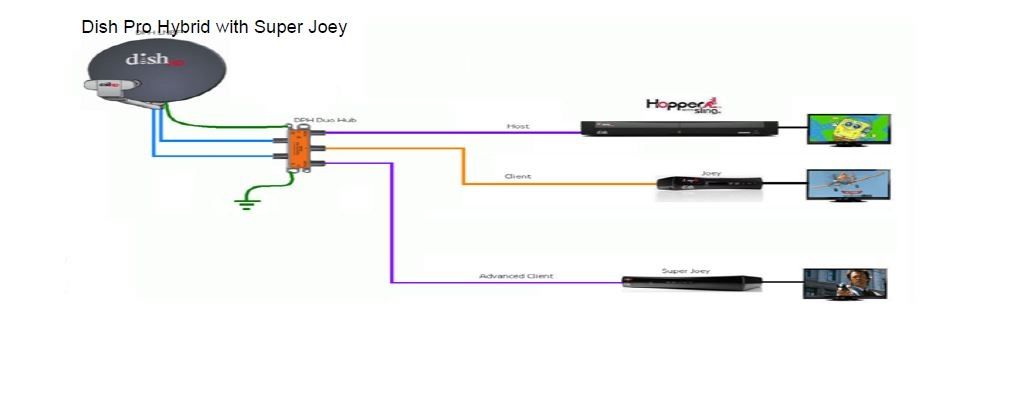

It doesn't make it more flexible for more Hoppers. As a matter of fact it limits you to two Hoppers or one Hopper + one Super Joey. If you want three Hoppers you have to use the "old" DPP LNB and associated switches and Nodes (instead of hubs). The advantage to this arrangement is that in a one Hopper system with no Super Joey you only need one wire from the dish, or in a two hopper or hopper+super joey setup, you only need two wires from the dish. This is also probably cheaper than a DPP LNB + Solo or Duo node.
So, for example, right now I have 1 hopper + 1 regular joey + 1 hopper internet connector. I want to add a super joey, and I'll just wait for this since I have two lines from my dish to a solo node, and then already have wires running to where they need to go in the house. I can replace the LNB with this one, and the solo node with a duo hub, and I won't need to run any additional coax at all.
