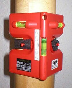

Back ontopic, your install should be simple, set the dish up, making sure the mast is plum. If you dont have a torpedo level go buy one, this parts really important. From there its just a matter of moving the dish slowly with a 1/2" ratcheting wrench or similiar.

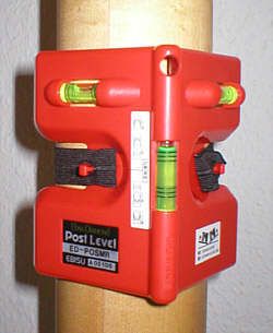

Just a note on kitty's post. I use a post level. They are easier to use and more accurate than a torpedo level.
You can get them at Home Depot or Lowes.
