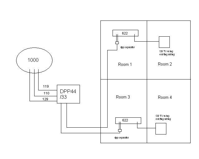

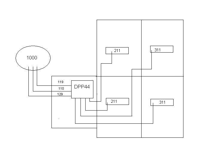

Here are a couple of diagrams for some of the suggestions for the least ammount of holes in your house. However if you choose the one with the extra hole, **I take NO responsibility for any structural collapse that the hole may cause** ha. The first is the only way to leave it at 2. The second is the way to hook up the receivers that you want had originally ordered. 3 is the minimum on that depending on which sats you need to look at (possibly more for hd locals internationals etc.)
