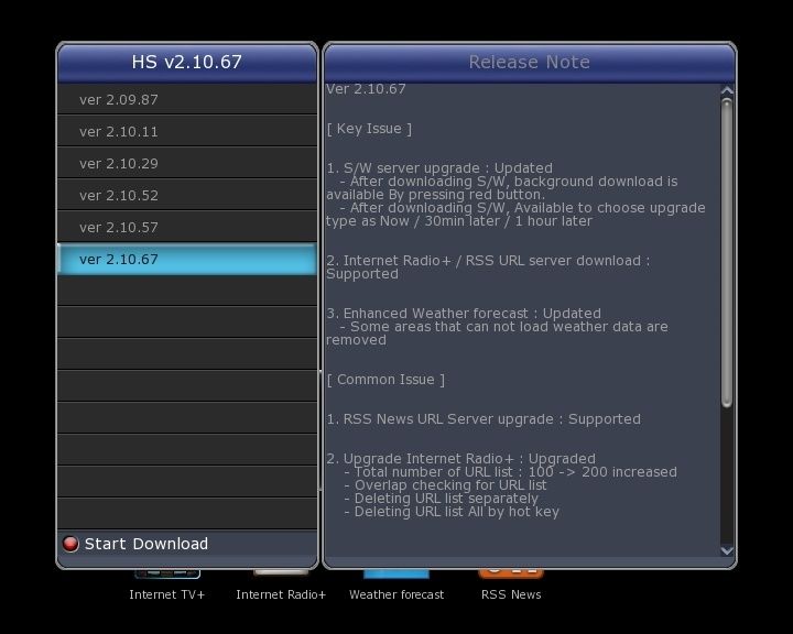

The Optibox receivers display firmware update notes as shown below. I find this to be a very nice feature.
I -- only one person - would probably not ever look at notes, however, if notes were a jpeg and downloaded to the usb stick, they should be available any time you wanted to read them, and if, as seems to be Brian's convention, the file name starts with a date, there would never be confusion what note went with what update. And on that... I would like to see a manual update choice that goes to the USB, for later installation - if not too much design / software issue.
