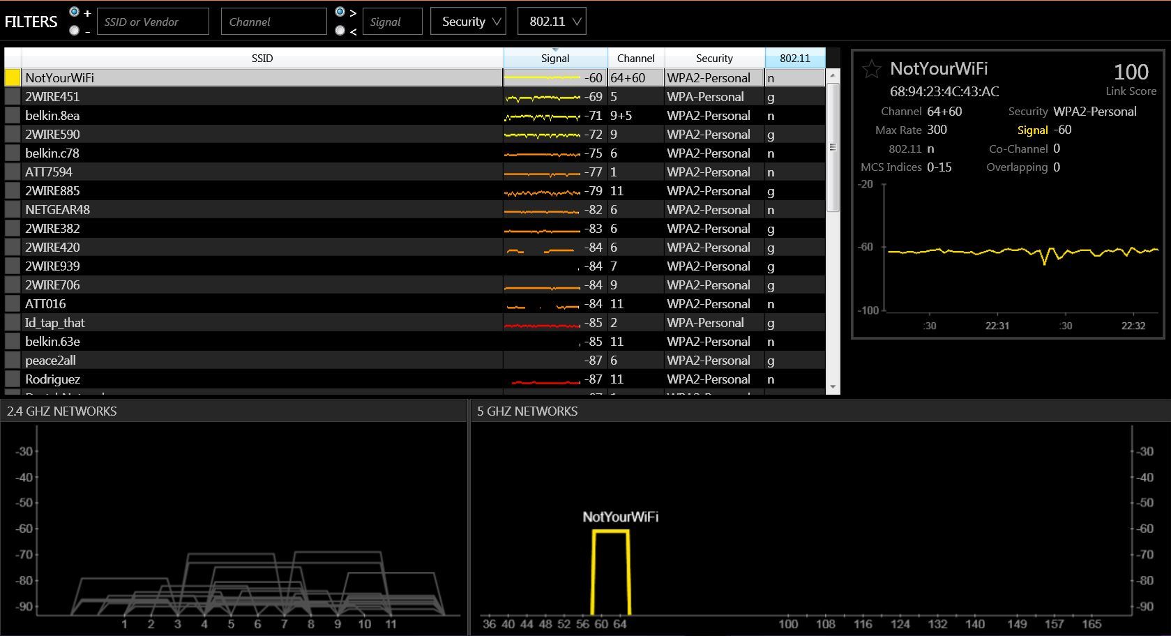

As jimdandyvi mentioned, inSSIDer is a very good diagnostic tool. At home I use 5 Ghz for all my wifi needs. I have zero 5 Ghz traffic in my area. Check the thumbnail.;)
