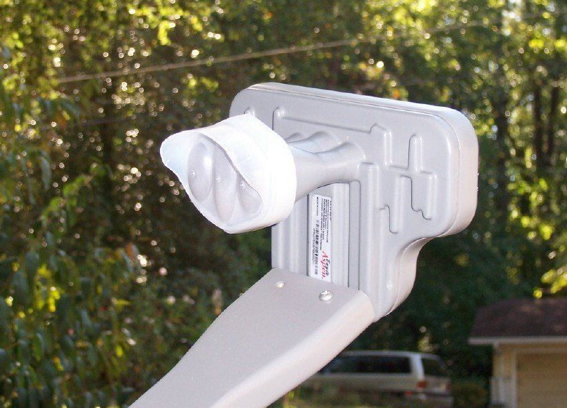

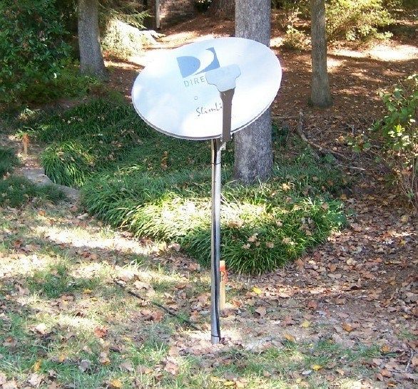

After 6 weeks of back-and-forth with DirecTV and a barely-cooperative local installer, my parents finally have HDTV, courtesy the new SL3 dish. Their very wooded location did not support seeing the 110 & 119, so this was their only option for reliable reception (although they did have a 'temporary' 5-lnb feed a few days prior).
Thanks to DirecTV higher-tier customer service for making this happen. But it was torture dealing with the local installer, where some combination of ignorance/laziness/not-getting-paid made getting this dish installed correctly almost impossible. The stories my folks were told about this dish not existing, not being able to see the satellites, not being able to find a good location (that was actually easy), still needing to see 110, 119 ..., and then they still left the wires above ground and left off a screw on the feed arm. %&@*)!#$

If there is NLOS for 119 then no installer is going to install in a 119 HD market, primarily because he will end up loosing the money he gets paid for that job, so its a waste of 2 hours. The 3lnb Slimline obviously helps tremendously with 119 NLOS issues but unfortunately there are still very limited areas D* is using it yet. In all other areas the HD Guide Data still streams off the 119 so we are still required to call a no line of sight on the entire install if the 119 can not be seen. I am by far not a lazy Installer but if the lot is as wooded as you say I would not be spending much time there either.
As far as the lines above the ground, that should not have happened, he should have either offered to bury it and post the dish for a cost or rescheduled the job for when you could have a trench dug, imo.

The dish itself is the same and comes the same as it always has, the only change is the 119 and 110 LNB feed horns are removed, as a tech we get the dish and LNB's separately, so if you have a AU9 now you can just swap LNB's although it would probably just be cheaper to disable 110/119 in the Sat Setup Menu.
On the Bulk box the 3 LNB say's SL3 if that helps.
So the LNB's that Fit the AU9 are
SL5 - 5 LNB Ka/Ku 99,101,103,110,119
SL3 - 3 LNB Ka/Ku 99,101,103
SWM5 - 5 LNB Ka/Ku Single Wire 8 tuner
SWM3 - 3 LNB Ka/Ku Single Wire 8 tuner
