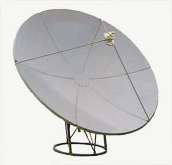

The picture above shows the type of dish that would be ideal for me. I like how it has the circular shaped base to set the dish on. I'm having a difficult time finding one of these. Does anyone know of a reputable supplier with a good price???
I would like a 6' dish to start me into C-band... something that won't be a hassle to setup. I saw the $69 special, but I read all the hassles people had putting these onto a pole, and I don't mind paying more to avoid the problems. I saw Iceberg had a dish like one of these that he manually moves and uses a couple sandbags. That would be a temporary solution for me until I can find something permanent.

Here you go, best price going, and these are GREAT dishes! http://www.hypermegasat.com/VS-180TVRO.htm
Or here for one with a polar mount: http://sadoun.com/Sat/Order/Dishes/C_Band_satellite_dish.htm I just set one of these up myself, and it's not hard, and they are a great dish also! Mine came with a 3" mount to use on a slab or patio, but I put it on a pole.

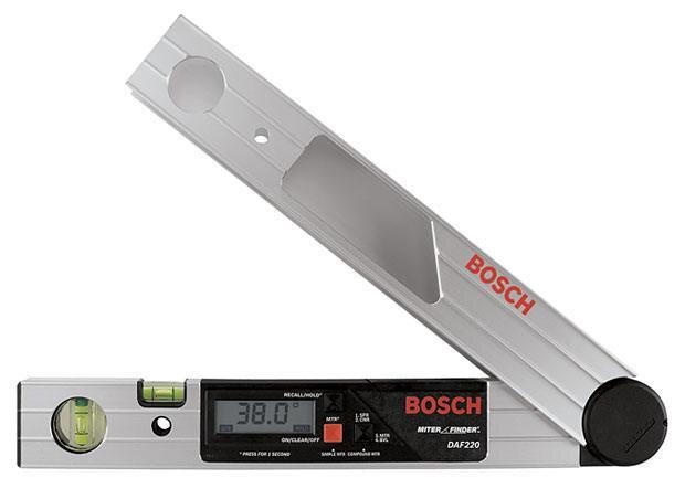

I'm very familiar with dishpointer.com. I don't have a smart phone capable of that app. I am thinking of buying some sort of angle measuring device... one that will give me an idea of how high the satellites are above the horizon. Any suggestions?? Whenever I have the satellite elevation angle, it's hard to imagine how high above the horizon it really is. From my research, it looks like there's lots of foreign channels on 116.8W, 58W, and 55.5W with some English programming scattered elsewhere. I would like to watch CBC on 107.3, but I read somewhere that it's not expected to stay ITC for too long. So I don't have much expectations with that.

Angle finder
bosch_angle_finder.jpgplace on a level surface with the arm set to the elevation. Rotate to 'look' along the satellites azimuth, sight along arm.
Angle finder
View attachment 80584place on a level surface with the arm set to the elevation. Rotate to 'look' along the satellites azimuth, sight along arm.
