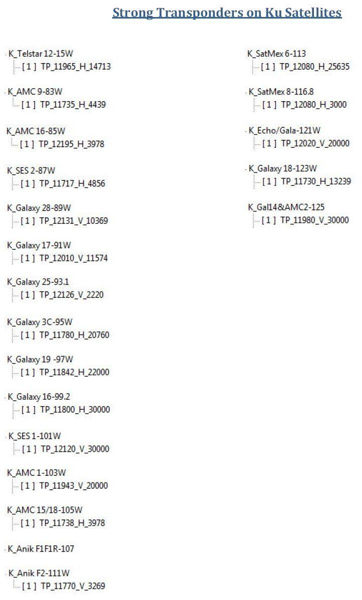

Perhaps a seasoned user here could provide a list from their STB (set top box) of the strongest transponder frequency for each FTA satellite to use for initial aiming.
Strong Transponders on Ku
Here's a start. This is a list of transponders that I would try to aim at for some of the satellites.

Thank you for the list cyberham! So my issue with it was Im using a motorized dish and did not read the part where the pole had to be exactly level once I leveled the pole I hit about 8 satellites and lots of channels except some satellites I am only receiving about 17 to 25 percent but the receiver says locked should i worry ?

Worry - no, but you may want to improve.
You will not get a 100% Quality reading, and every device will show a different reading, but I would guess there is room for improvement.
The weaker the Quality, the quicker weather will degrade the signal.
