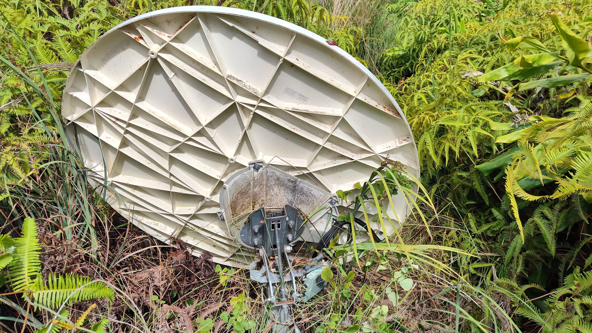

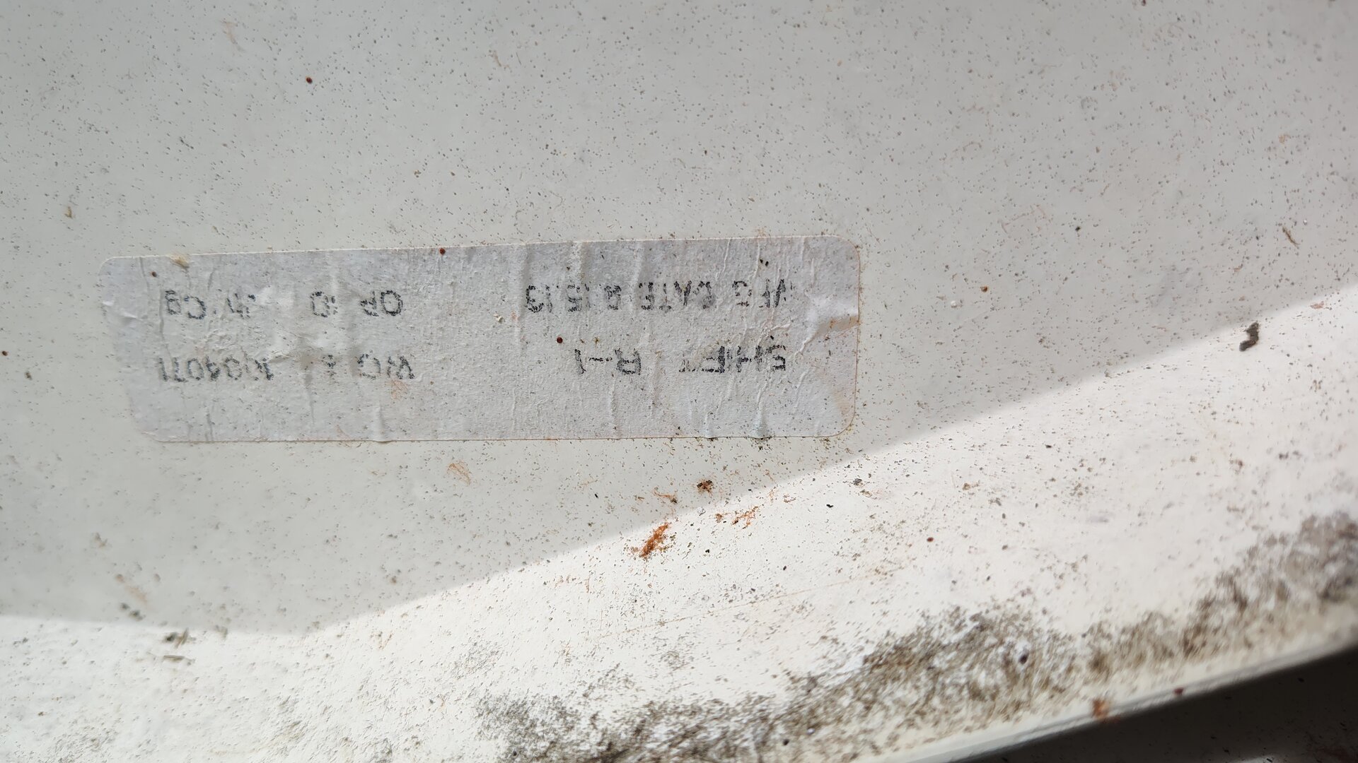

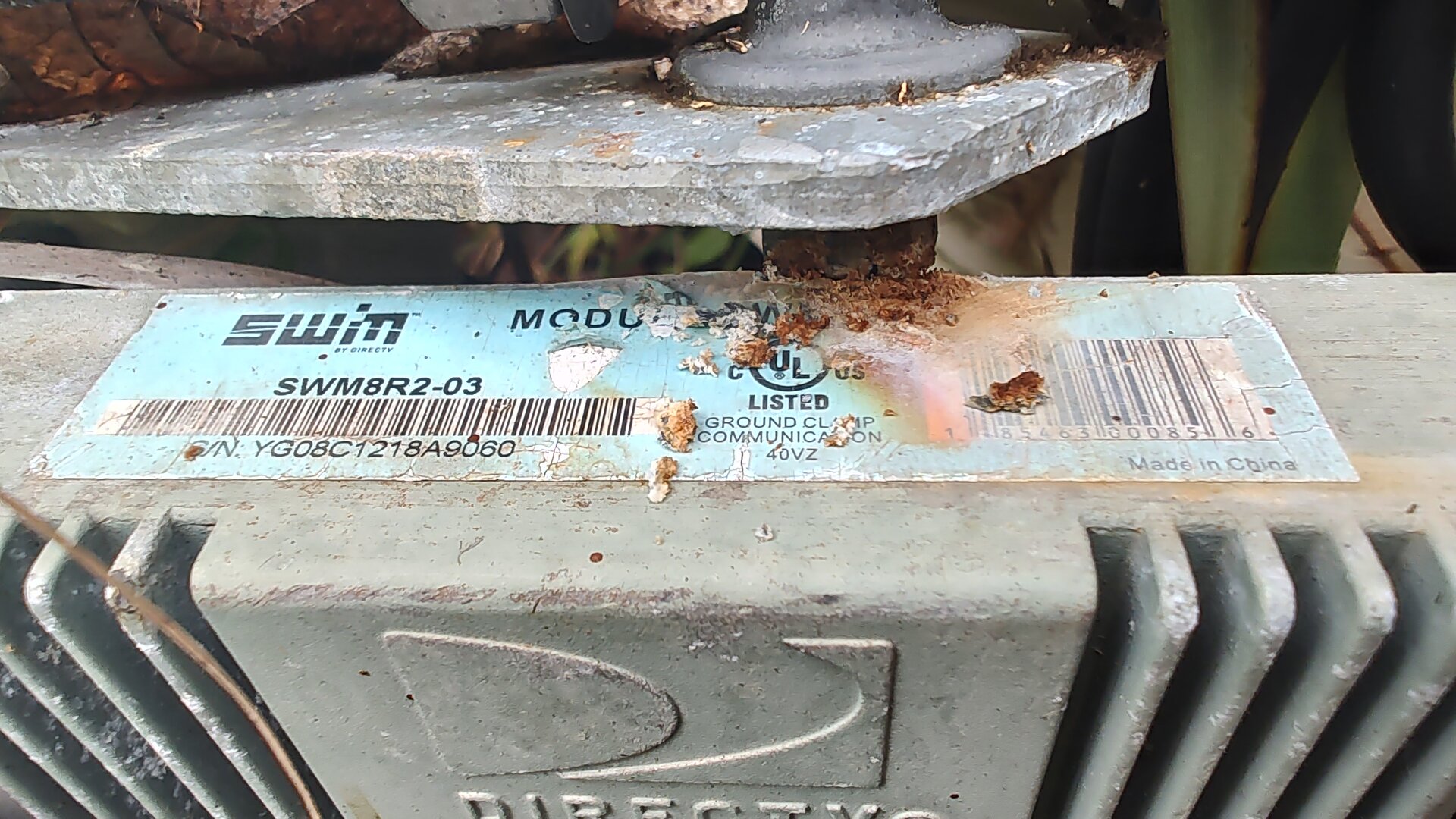

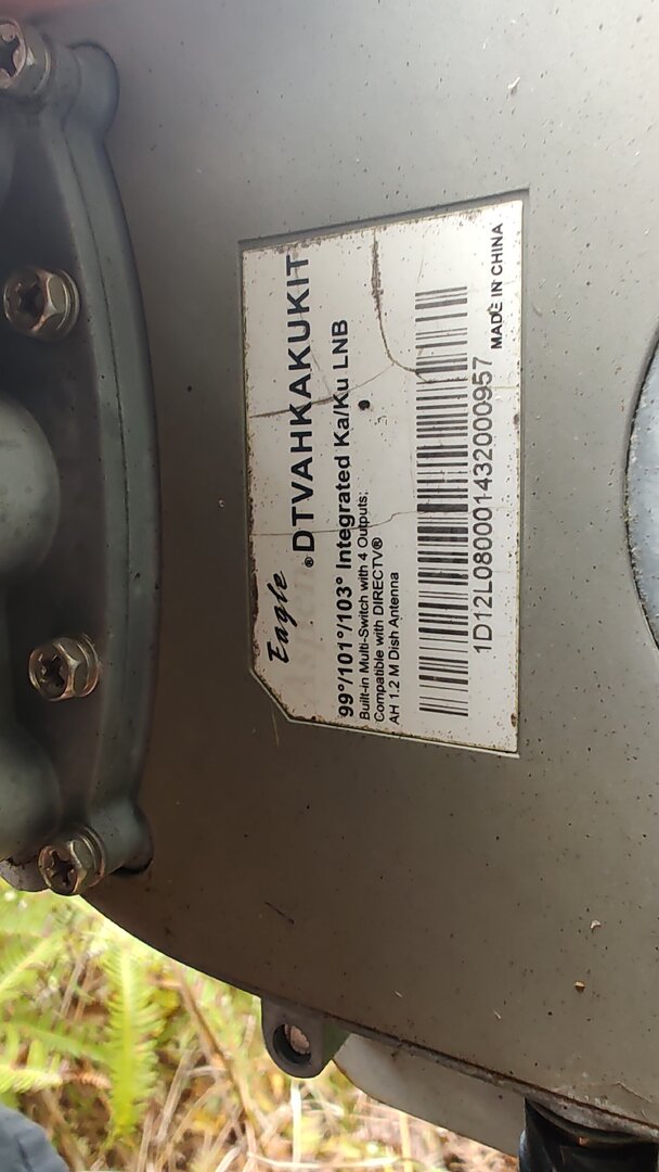

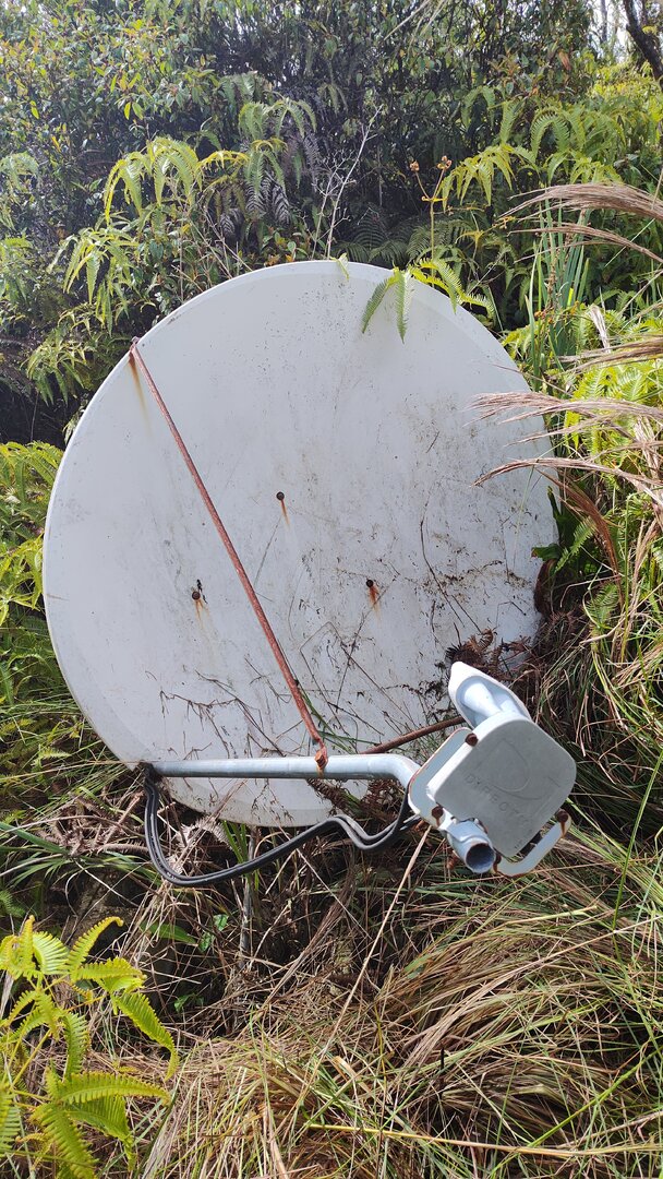

Here is pictures if the dish i have. Sorry it got lost in the jungle.
View attachment 163754View attachment 163755View attachment 163756
I can also take more detailed pictures if you let me know what you are looking for!
You're welcome. A far as I can see that dish should be good for fta. If you manually scan then you would need transponder info and such. If you do a blind scan then no, the receiver will find and log the frequencies it finds. :)
