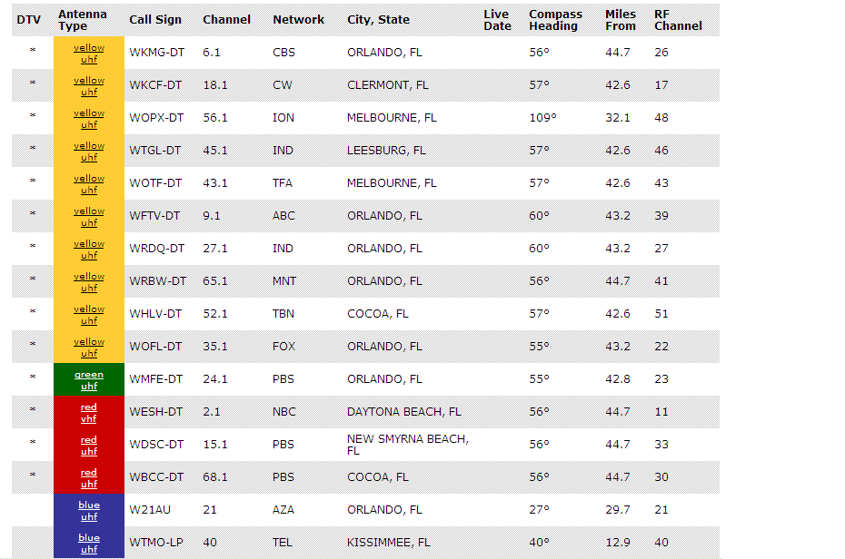

I have looked through the posts and didn't see the issue I am having, but I might not have searched for the right issue/solution. I am very new to OTA TV, until recently I didn't know that there was a solution to getting 'local channels' that are pretty far from me. I did alot of reading online and finally purchased an RCA ANT751, installed it on the back of my house, just below the roofline (two story) and pointed it to 56 degrees. I used RG6 quad shield coax, which runs about 40 feet from the antenna to the tv. I am able to recieve all the yellow, green and red stations, but the VHF, especially the lower stations, are very sporadic and I would like to recieve them.
My questions are, did I buy the right antenna, if I add a pre-amp will that help, or just add more noise and make the channels that are coming in go from good to less good? If I add a second antenna of the same model (is it stacking or ganging?) about 10 feet from the first antenna (horizontally) and point it to 56 degrees, will it solve my reception problem? I would appreciate any thoughts or suggestions you might have.
Yellow, green, red stations ? Is this from antennaweb.org or tvfool.com ? Can you share the results that either of those give you ?
You mention 56 degrees, quad-shield, pre-amps, etc, etc so it sounds like you have a pretty good idea on this stuff... :)
Amplifiers are good and bad. They can help and can also hurt reception. I wouldn't even consider one unless you're 30+ miles away.
I have read alot, and much of it is contradictory. They don't all give dates of when the information was posted, and there may be differences in the situations that I can't see or understand. I used Antennaweb.org, but think that the response was similar on the other site as well. Here it is: Antenna Listing.GIF
From what I've found so far I'd say the antenna you have is designed more for the High VHF channels and not the lower end VHF channels.
You'll need a different antenna, maybe a pre-amp might help or even stacking another one might improve your signals.
Yeap, I'd agree with sergei. That antenna, though it CLAIMS to work for VHF, isn't by any means "optimal" for VHF. If you were less than 10 miles away, I'm sure it would pick up those VHF channels just fine, but at 45 miles, it's a different story.

Channel 11(2.1) is the only VHF channel and it is VHF HI just what the antenna is designed for. Ch 6.1 is actually broadcast on UHF CH 26 9.1 is actually UHF CH39.
I agree with Don M the 751 maybe marginal but getting it above the peak of the roof may change reception. This East coast area is basically flat so RF distribution may exceed expectations.
With broadcast locations from 27-109* you will have trouble getting the extremes but with most in the 55-60* range those should not be a problem.

My zip code is 33837. Looks like I am about 40+ miles from both the Orlando and Tampa stations. This antenna that I have is doing a good job getting all but the low VHF stations, which is NBC and I would like to get that clearly, and some of the Tampa Independants would be nice too.
First, the NBC (WESH) station and (WFLA) station both show them to be VHF-Hi channels per TVFool.. So your antenna should be OK for what you want.

I got the antenna up on Saturday morning, and was able to hook the antenna up through my Tivo. I am now getting the lower VHF channel, but appear to have lost some of the Tampa channels that I got when the antenna was on the house (which is surprising, because the house should have blocked some of the signal, that there is no block for now). I was able to check the signal strength once the antenna was up above the house, and the Orlando stations are coming in 71 to 100. The Tampa stations are 28 to 60. I am using Tivo to convert the signal, not a converter box. Before the Tivo arrived, I was going straight into the television.
