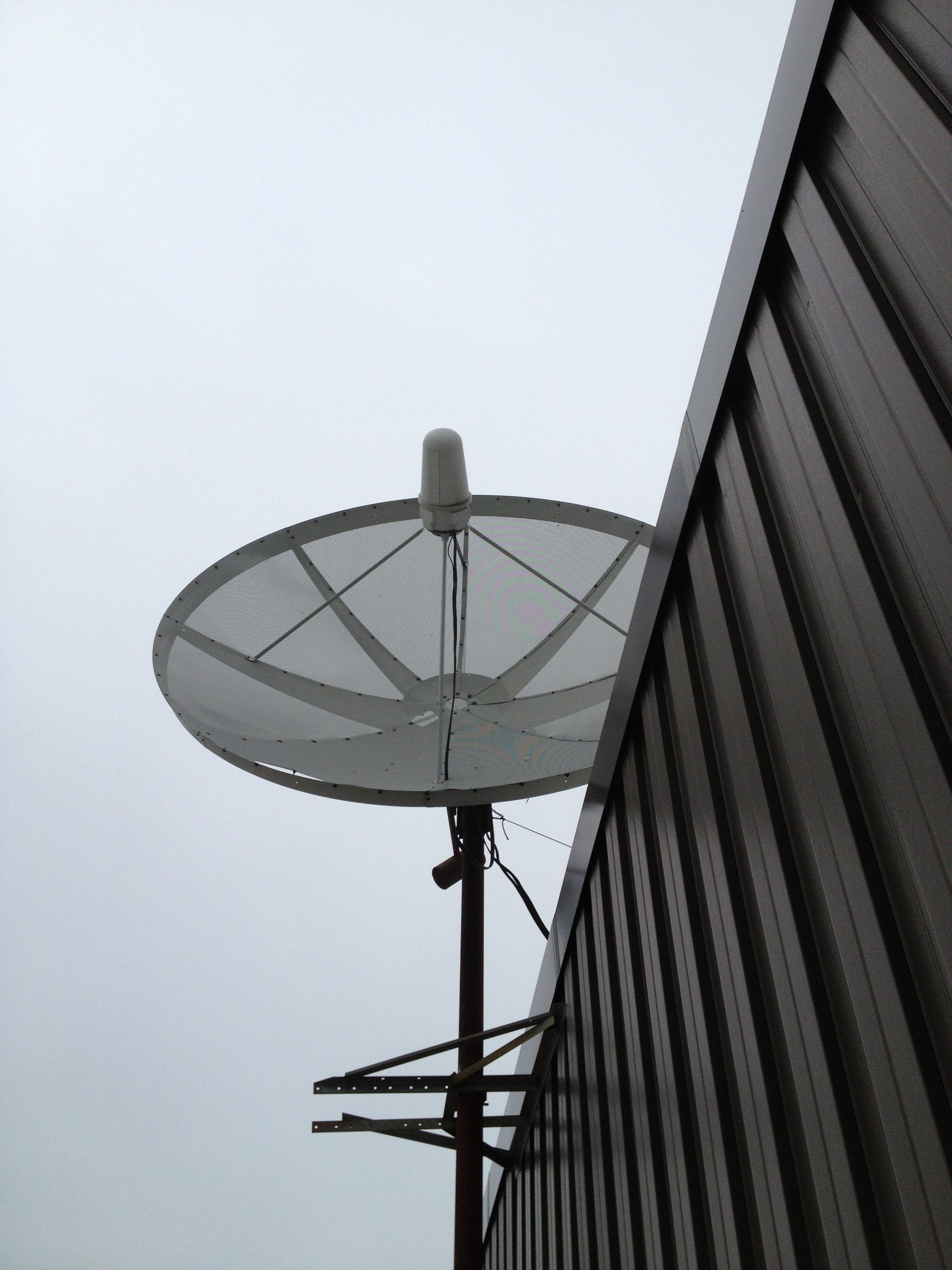

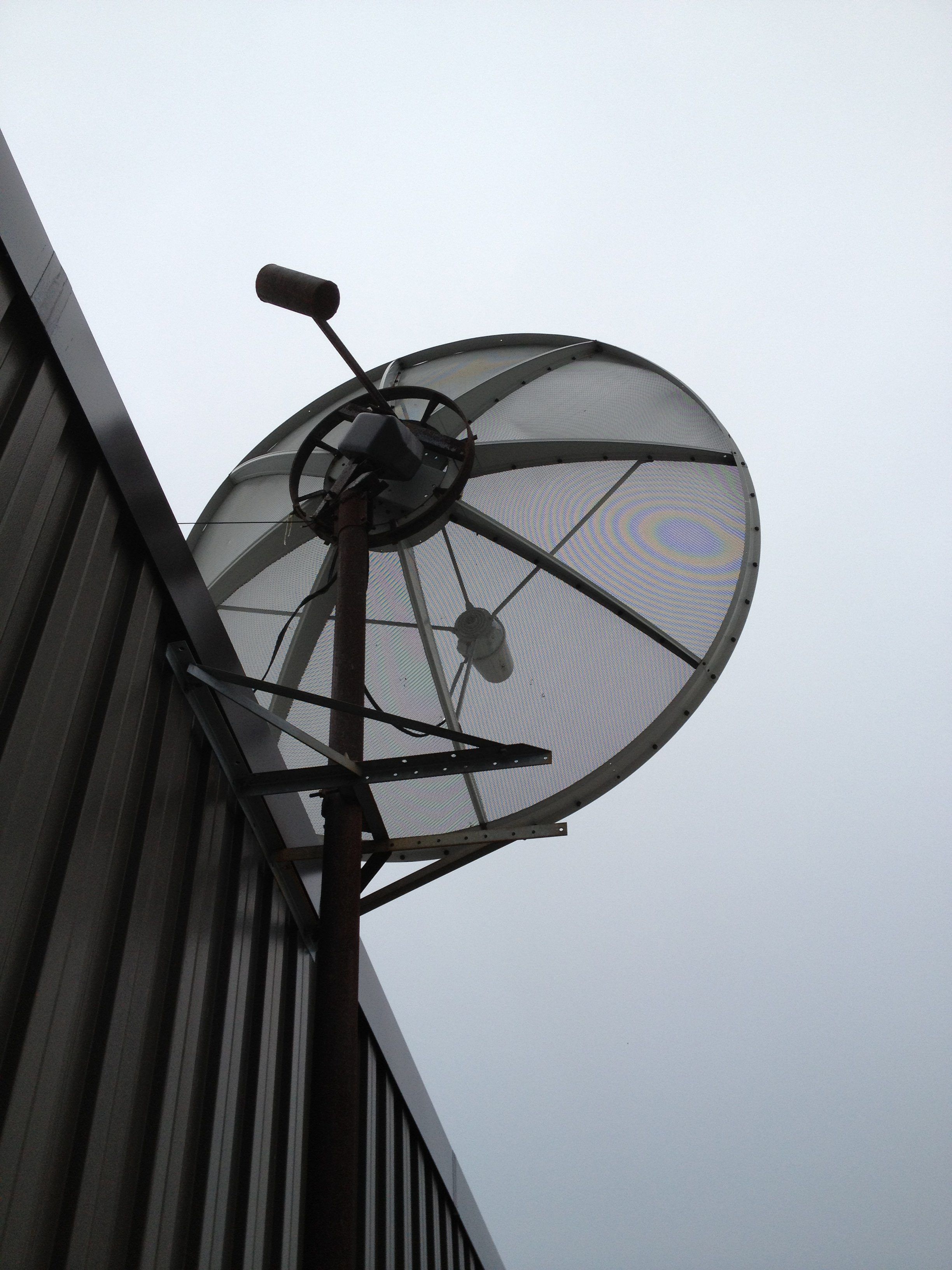

You would get nice PBS coverage if you were to aim the Ku-Band dish at 125W and connect a DVB-S2 receiver to it. Looking at the pictures, you probably have a single-polarity LNB on that dish, so to get everything on both polarities you'd want to upgrade the LNB.

I think most of us would agree that a fixed Ku dish could be figured into your system. Don't be too hasty about removing that nice dish.;)
As Brex2001 said, there is no need to remove the Ku dish from your system. In fact, I would think the PBS channels on 125W would be very useful in an educational environment. Combining the outputs from the Ku-Band dish and the C-Band dish is not a complex procedure. I would certainly park the Ku-Band dish on 125W.

Does the C-band dish receive Ku band signals, or is it necessary to have a separate dish for those?
That depends on what's used for a 'feed' electronics, the LNB or LNBF. And also the size of the holes in the mesh. For Ku on a BUD, the area holes should be much less than the area of the solid surface to be usable on Ku. **
Tell you what I'd do - Just hook it up to the coax from the small white dish, and do a blind scan. See what transponders and channels it gets, and determine what satellite it's aimed at. Then go from there.
You can add a DISEQC or 22khz switch to 'switch' between the small dish and big dish
Maybe re-point the small dish to 125W for PBS? But even there, I think most is HD or S2, and don't think a Duo does either S2 or HD. Should get the SD feeds and channels tho--

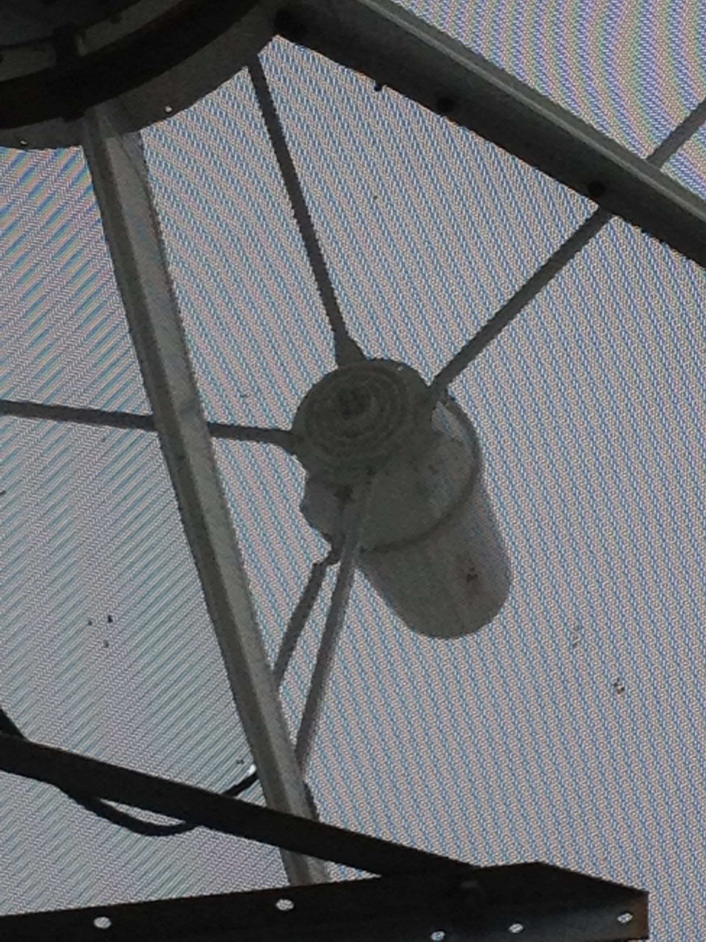

** Tell ya what, take some pictures of the electronics in the front of the dish, we'll tell you what they are capable of.

You would need a C/Ku combo LNBF on the big dish, and these LNBFs tend to be hard to tweak and usually result in poorer performance on one band or the other. Best to keep a separate dish for Ku-Band.
