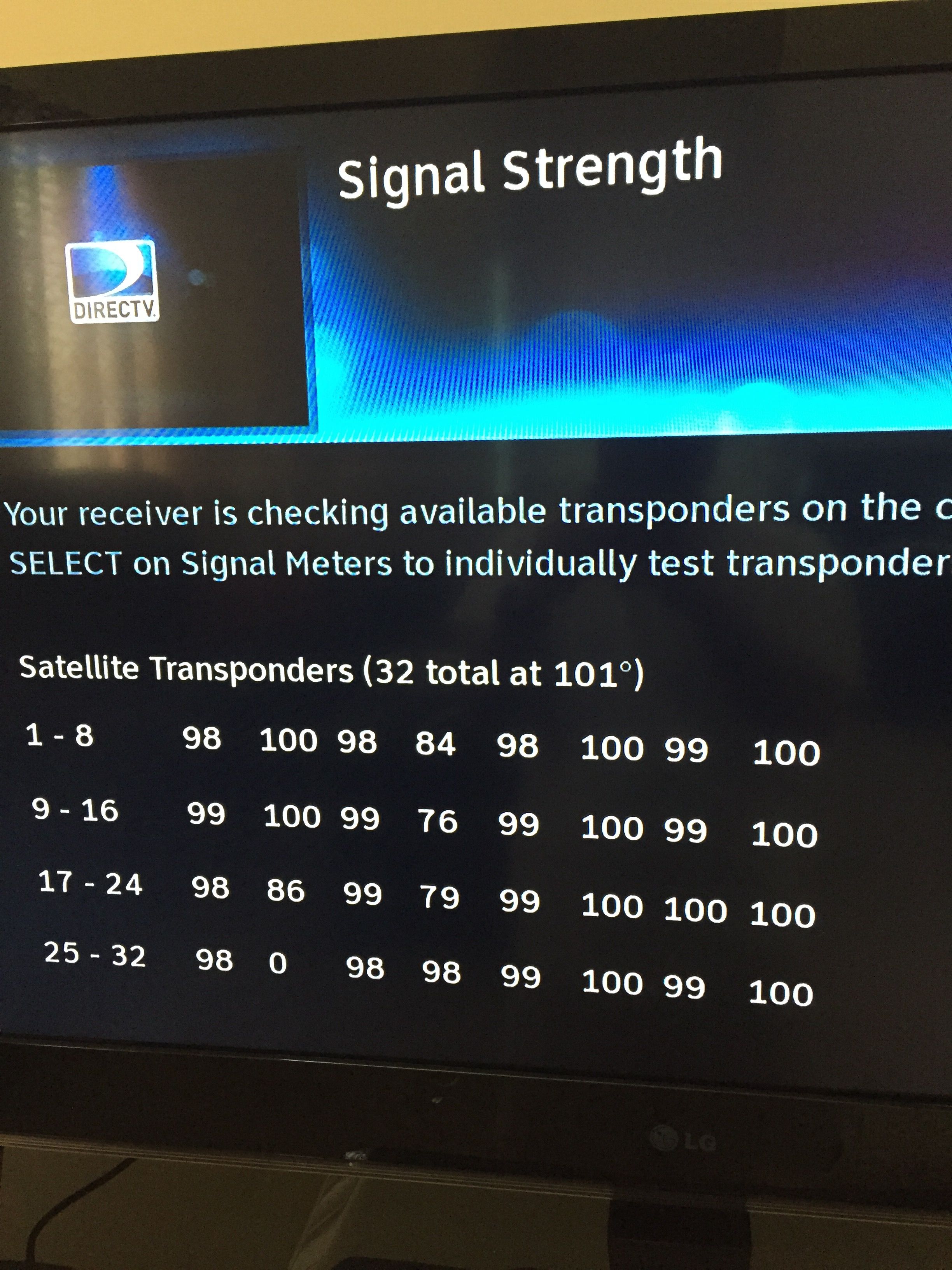

Hi ya'll, I'm officially a new member of the Directv Family as of today. I dumped my former cable provider (Suddenlink) after they changed and dropped a lot of the Viacom/other channels that I miss and enjoy watching. So far I'm very impressed and am loving my new Directv service! I have a question though that maybe someone can answer for me....... when I go to "signal strength" that shows the 1-32 transponder numbers readings, are there certain numbers/transponders that I need to pay attention too and if so what number reading are they supposed to be at?
Here is an example what I'm talking about:
1-8: X X X X X X X X
9-16: X X X X X X X X
17-24: X X X X X X X X
25-32: X X X X X X X X
Thanks!!

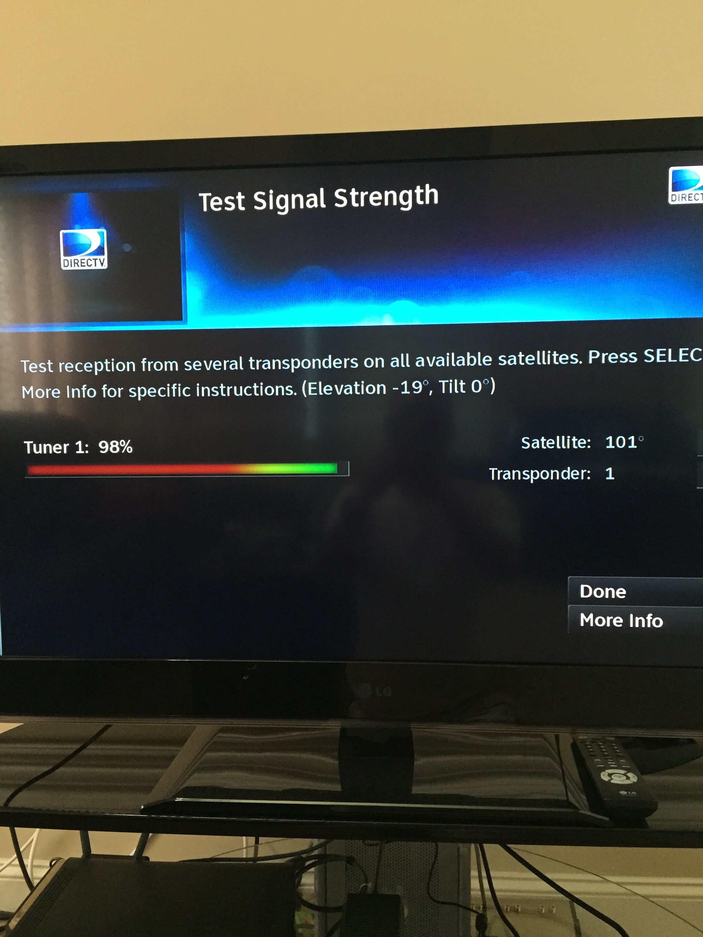

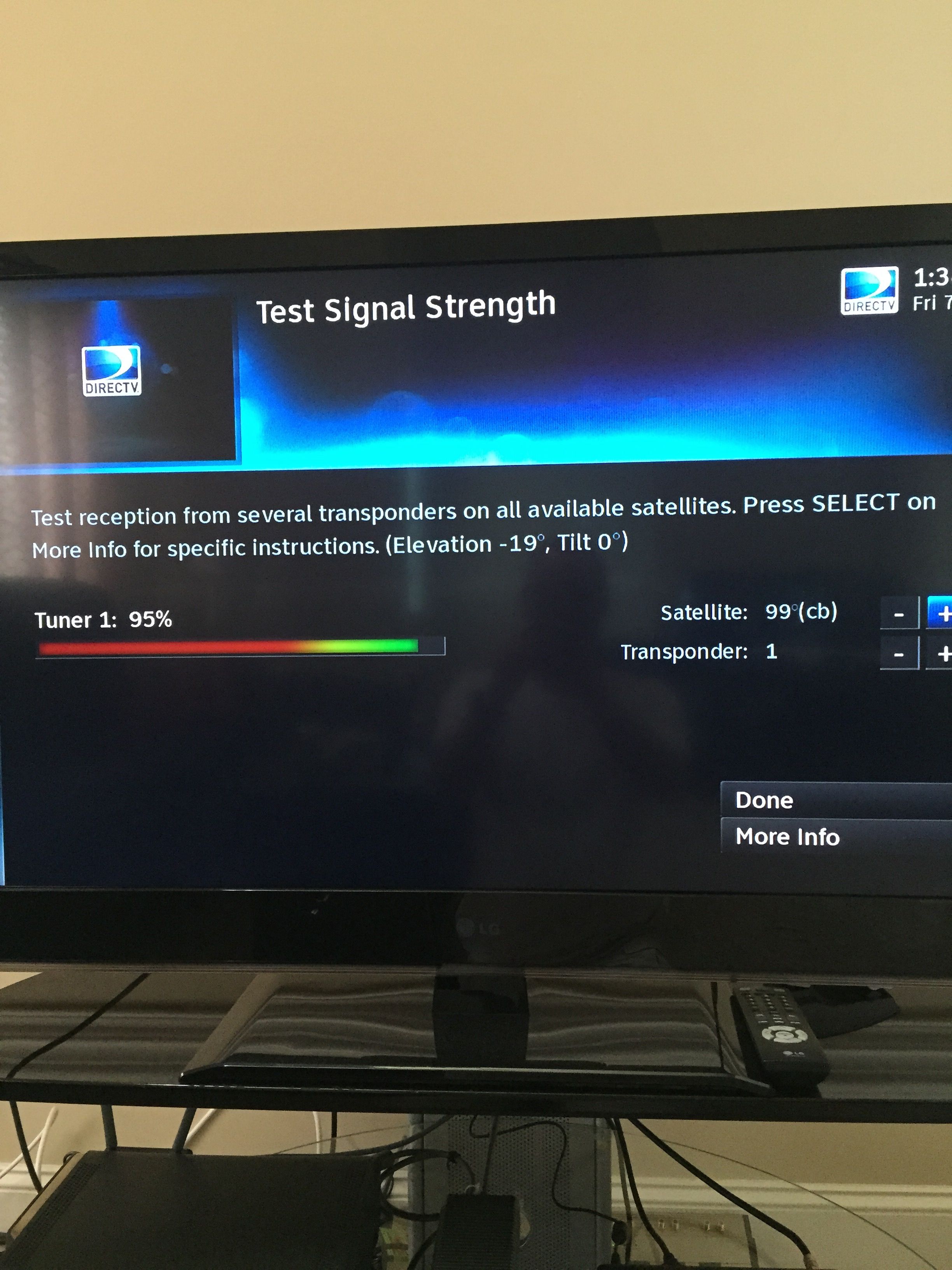

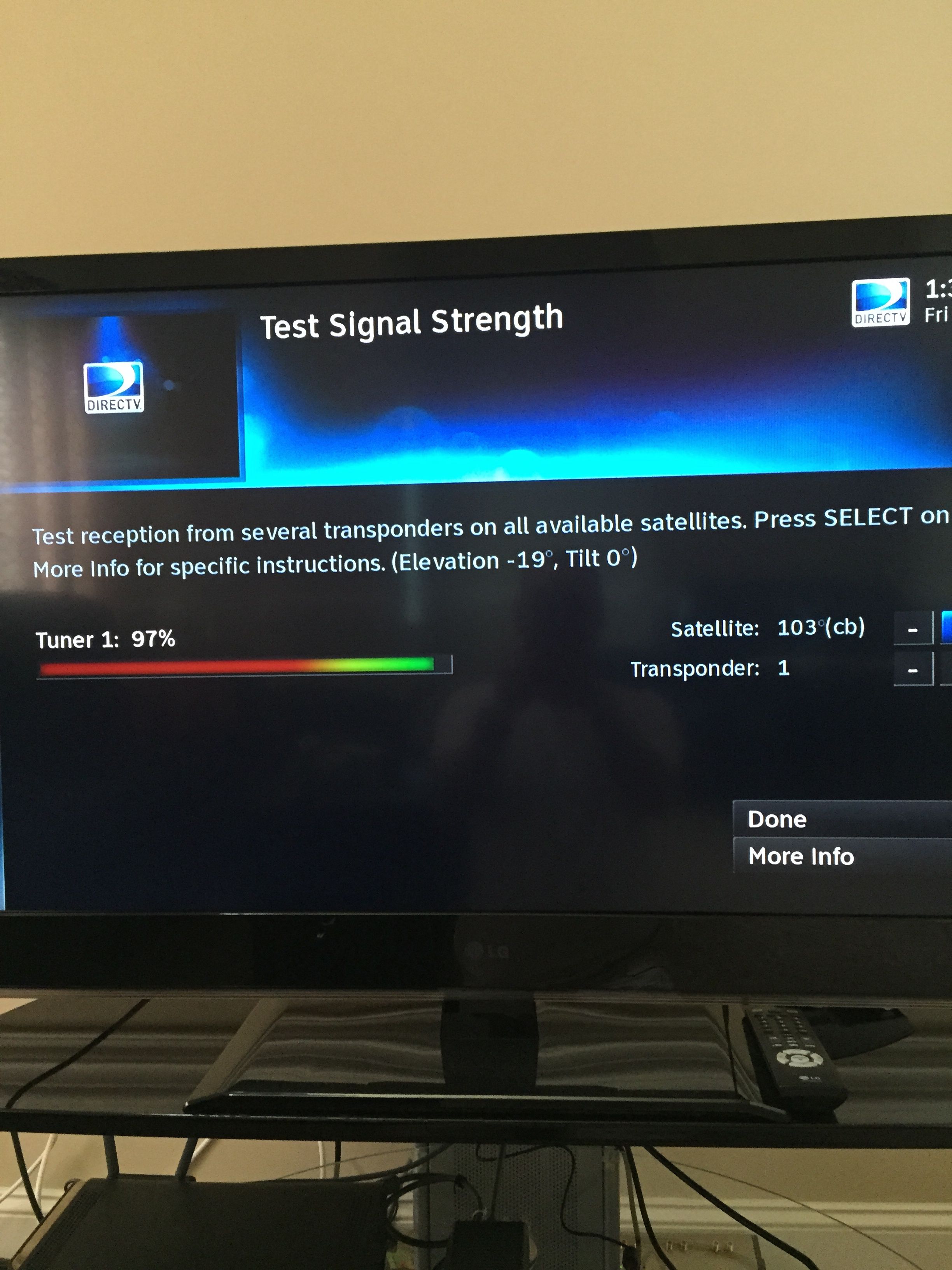

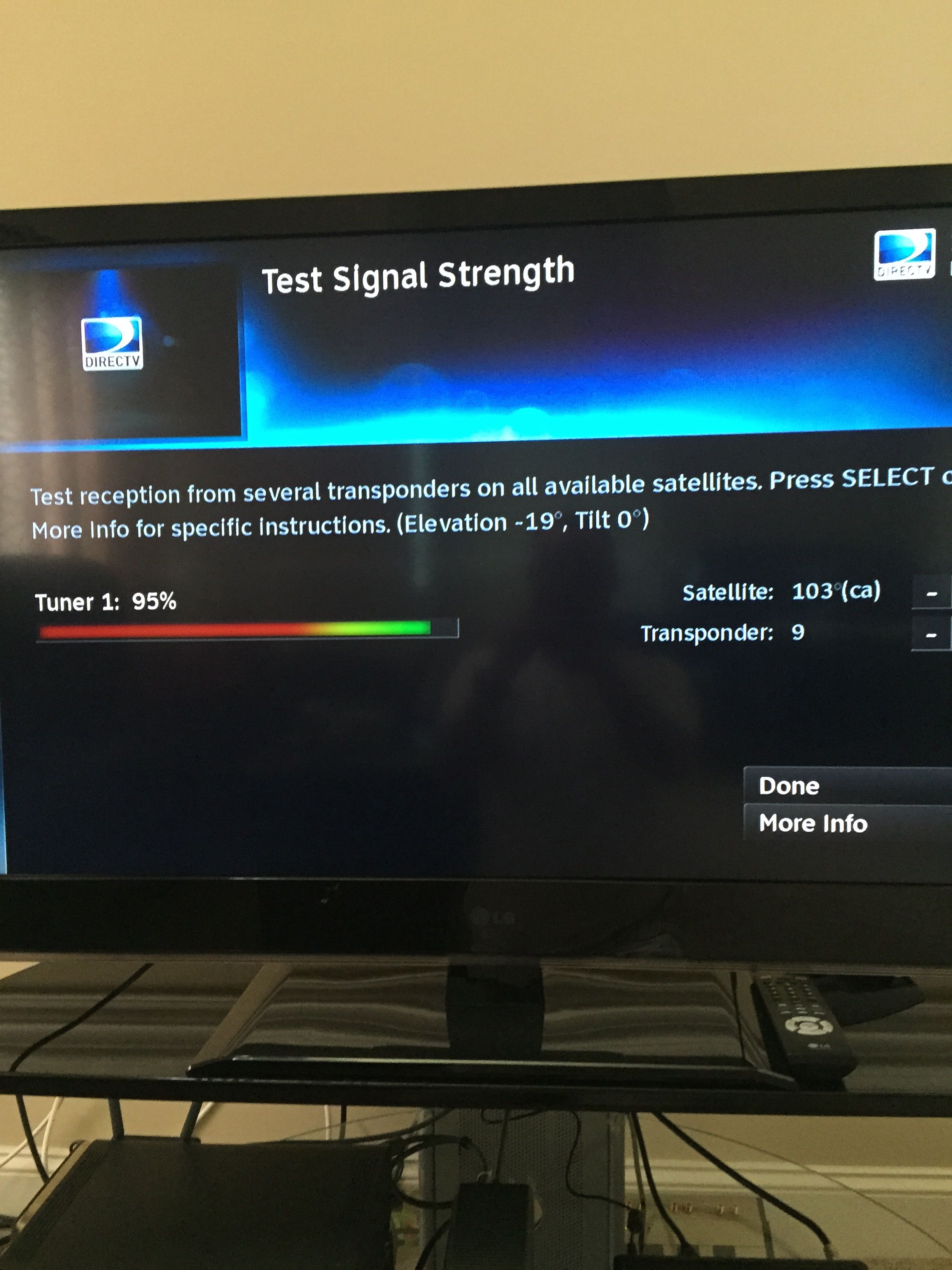

Thanks ya'll for the FAST and HELPFUL responses! Here are the satellite level readings I'm getting on my receiver. Let me know if they are good or not. Thanks!
They look fine but you are looking at the wrong screens.
The 101 screen is the correct one, but there are screens just like that for the other satellites. Next to the 101 at the top right you will see a +/- Click the plus button and it will move you to the next satellite screen and so on. There's also a +/- that will allow you to look at the signals on the other tuners - two tuners if you have a DVR, five tuners if you have a Genie. The other tuners should have basically the same signals as tuner 1.
Look good to me. But the reason for looking at the screens which show ALL the transponders is in case there is a problem with just some of them.

Hi ya'll, thanks again for all the quick and helpful responses! I have a quick question though and was just wondering how would ya'll say my satellite signal is?: PS: (I'm not having any problems at all with my Directv. I was just curious and wondering what ya'll think. Thanks!)
101:
1-8: 99 100 98 88 98 100 99 100
9-16: 99 100 99 79 99 100 98 100
17-24: 98 83 99 86 99 100 100 100
25-32: 99 0 98 99 99 100 99 100

99(cb):
1-8: 92 95 89 95 91 91 92 95
9-16: 92 92 94 95 96 95 N/A N/A
17-24: N/A N/A N/A N/A N/A N/A N/A N/A
25-32: N/A N/A N/A N/A N/A N/A N/A N/A
103(ca):
1-8: N/A N/A N/A N/A N/A N/A N/A N/A
9-16: 96 90 95 95 95 95 94 95
17-24: 95 95 95 96 95 95 96 98
103(cb):
1-8: 96 97 95 95 95 95 95 95
9-16: 95 95 95 95 95 95 N/A N/A
