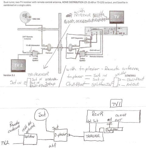

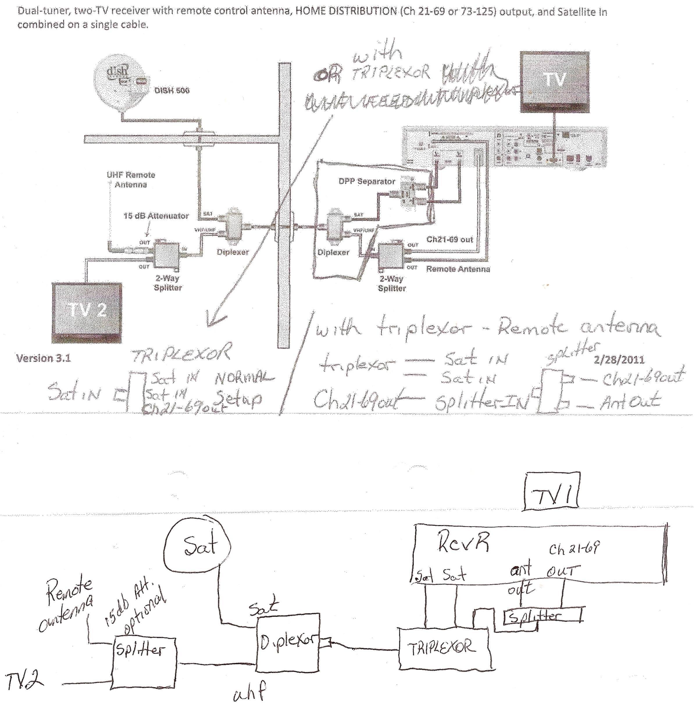

JPJ- you need to move your remote antenna to the bedroom you are now using as TV2. It requires two splitters and 3 pcs of cable.
I will try to find a diagram for you
Here is a rough sketch of a remote antenna with a triplexor also...
