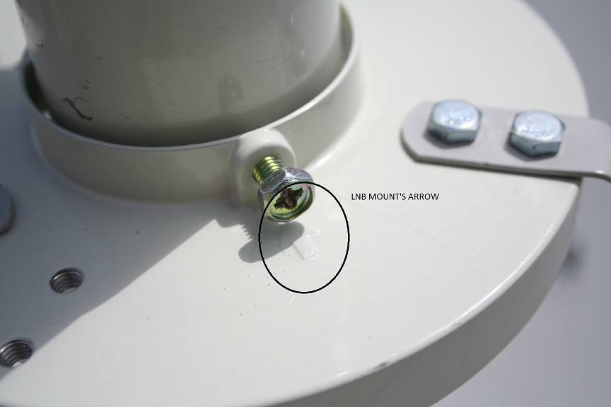

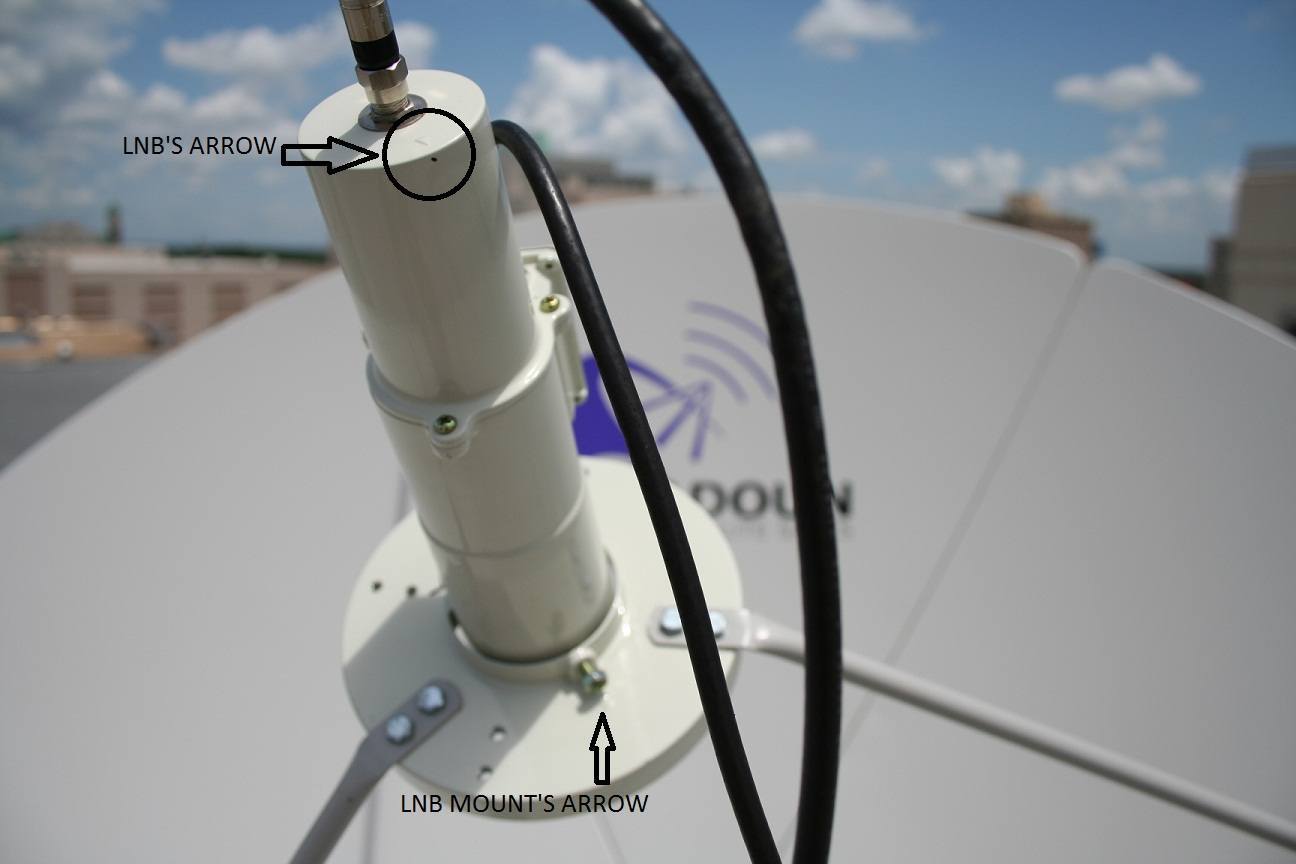

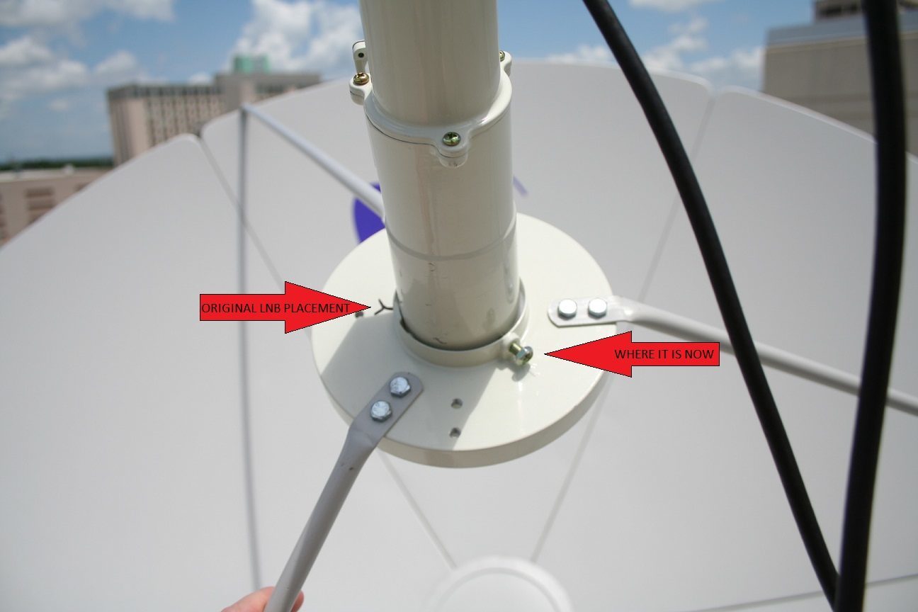

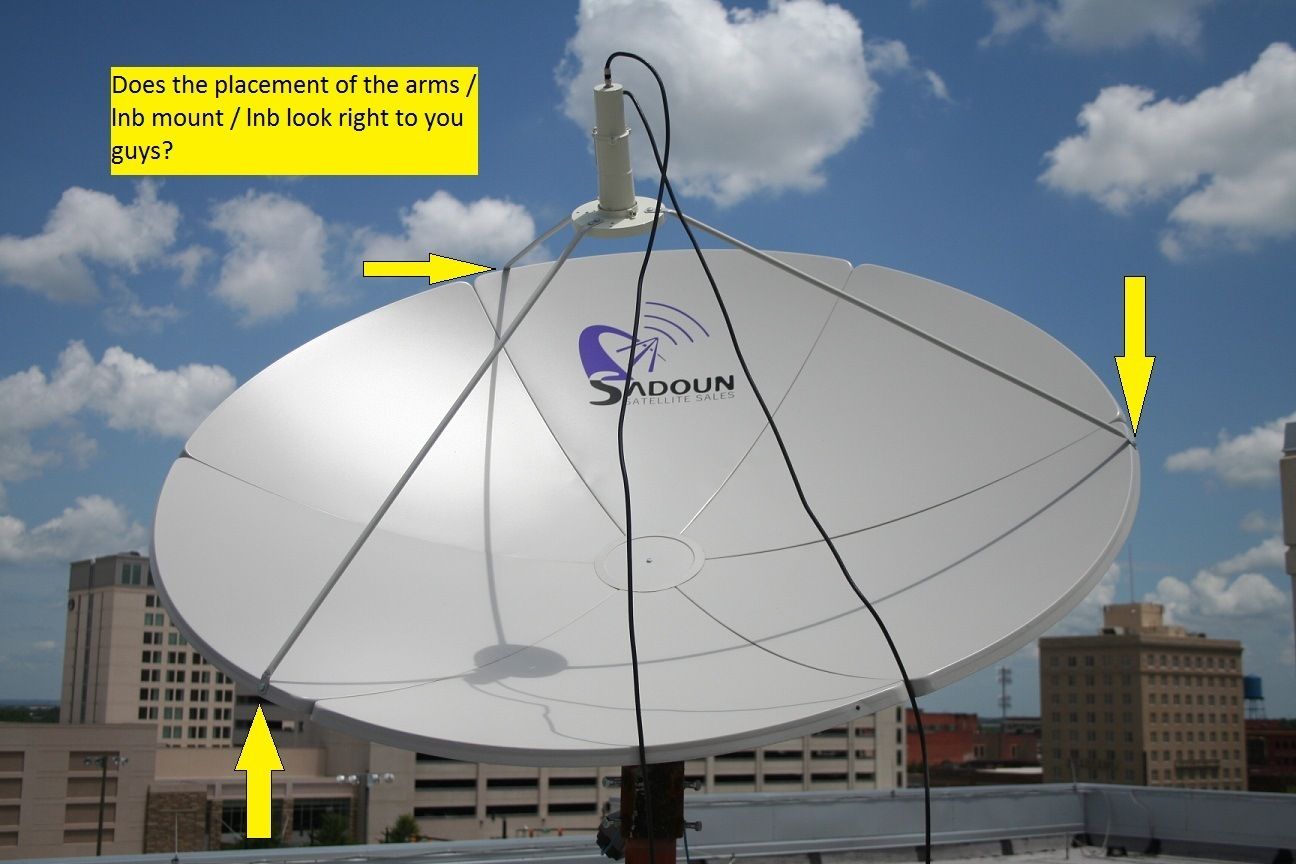

Ok. Jim, I installed the dish and I just "met" the two arrows. I came down the check the reception and i had less than I had before. But I think I mounted the LNB incorrectly. Here is the bundle we got from Sadoun ( MKit-3 FTA- C/KU Choice Set ). I may take some pictures in case I am doing something wrong.
I never installed a C-band dish, nor a prime-focus dish. But I'm assuming that as long as it's on a polar mount, the skew will be correct for any satellite you point at (except AMC-1-Ku.) Someone else will have to help you as to verifying that you have the correct focal depth.

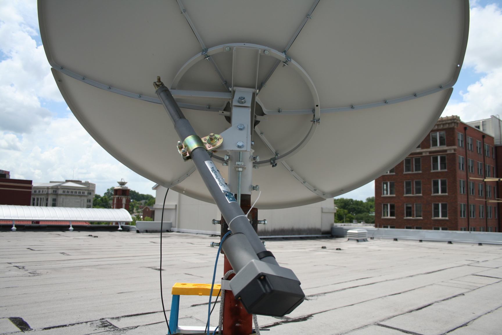

here are some pics of the install. I just wanted to give you guys a feel for what I am working with and to see if I made any mistakes in installation.

Same dish (although on a polar mount) as my PortaBUD on 87W :) ... The placement of the LNB legs is the same as on mine, but I don't have the same LNBF so I can't comment on that. I use the Eagle Aspen B1SAT stacked C-Band only LNBF on mine.
