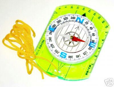

Pick yourself up one or two of these for your cars & toolbox. They run about $12 at any Wal-Mart or hunting/outdoors store. It will allow you to see the antennas heading, and adjust it if needed.
FOX is at 165° and 57.6m so a fairly large antenna high up should be in order.
CBS is at 88° and 44.7m
ABC is at 72° and 29.6m
NBC seems to be from a repeater at 351° and 31.6m.
What an ugly situation.

Welcome to living in the middle of nowhere! :) So basically with that many different headings there's probably no way I'll be able to get all 3. I know the antenna I have right now is a directional antenna.
Well I am no pro installer, but I would never say impossible; it will come down to your desire, budget, and how the receiving setup my look on top of your home.
Well I'll find out next time after I get a chance to get to town and get a new coaxial cable (I moved my tv and current one isn't long enough) and a compass. Thanks for all your help charper
