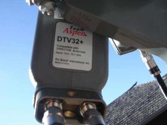

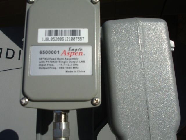

Post a couple of pictures of your dish and LNB.
Provide any info on the LNB label. (the one at the dish's focal point)

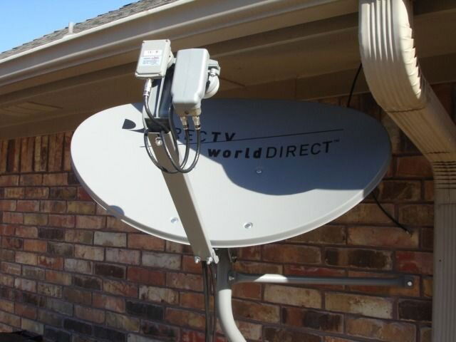

Wow thanks for all the response!!!
I took some pics of the dish setup so you can see whether i dorked something up.
I am going to try all the rest of the good advise.
Will keep you posted.

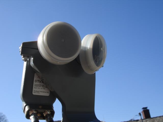

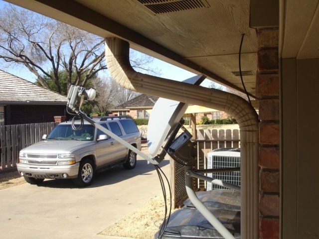

Sorry it looks to me as though your dish does not have clear view of the sky. because of the elevation you need it looks like the roof overhang will block a lot of signal. The single LNB looks to be linear but the dual is circular polarity
Took pic from other angle but you could be right....
