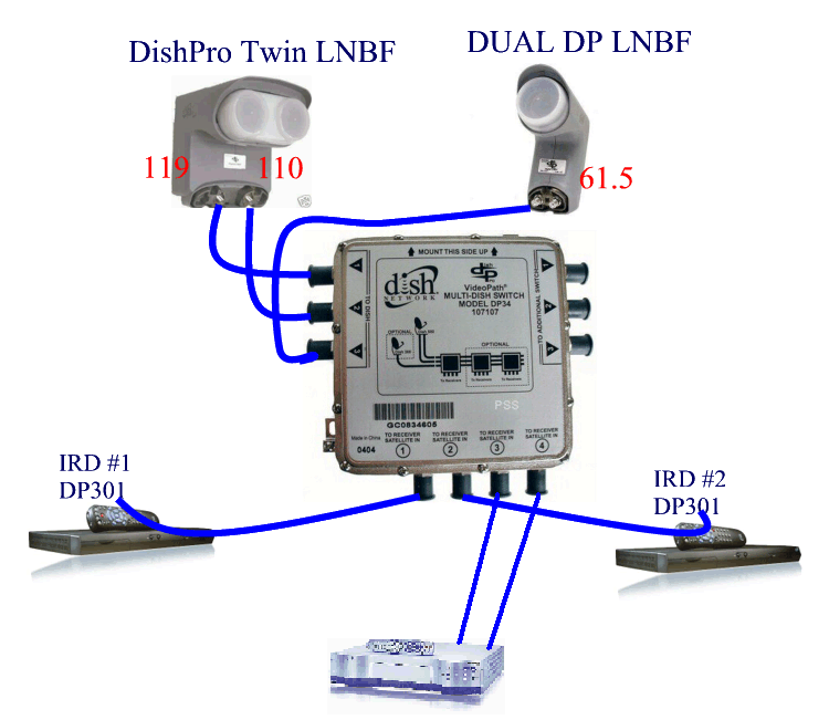

Hi Guys,
I have a problem, i'm adding DVR 921 to my currently i have 119,110, 61.5 going to dp34 and running two 301-013 with it, i added the 921 to the remaining two spots, ran two wires to dvr921. When i do switch test it does not detect 61.5, just shows 119, 110, and says just dual on the 3rd spot.
Why isn't the 61.5 detecting?
I have another dp34 i tested with that aswell same result.
I tryed only running 921 on ports 1&2 still same problem will not detect 61.5
thanks in advance here is my setup diagram.
attachment.php
Also, take the 61.5 input to the switch and barrel it directly to one of the 921 feeds. Do a check switch. On the check switch screen, you should show data for only one tuner, and one location on that tuner. If it still says Dual and no sat info, there might be something wrong with your 921.
