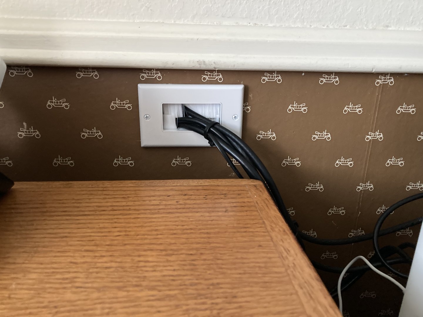

There a few options for neatly passing wires through a wall (assuming it's not brick or concrete block). I've used a version of this to pass speaker cables as well as satellite coax through a paneled wall to "dress it up".
yah the problem is puting hole in wall in first place even if it cover with plate, and I dont want hear them so I have not done it either way wifi issue is not coming from routers side it h3 side or more so there upstream or downstream.
