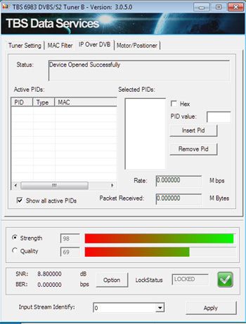

I converted my dish back to C-Band today, pointed it to 101W, and connected it to a TBS6983. The TBS IP app would lock on 3994V 20714. But when I went to the "IP over DVB" tab it would not show any PIDs, even after I checked 'Show all activePIDs'. (Screen shot below)
So I ran TBS recorder and recorded 60 seconds of the stream. Then I looked at it in a hexadecimal editor and the recorded stream was almost entirely zeroes!
I am perplexed. Wondering why the stream doesn't appear to contain any data? Maybe it doesn't transmit all the time, is currently down, or ???
Aside from that, I have been doing a lot of online searching today and it appears that 'Nbsp' is the software that most people are using to process NOAAPORT data: NOAAPort and Nbsp
So, once we figure out how to create a stream the software part doesn't look to hard.

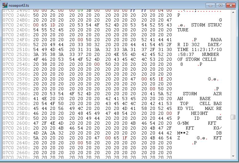

OK, please disregard the above ^^^^^^
After more searching I finally found the NOAAPORT stream. On 9/9/2014 they changed it from 3994V 20714 to 4040V 30000. On a web page instructing users how to reconfigure their receivers, they tell them to change the frequency to 1110MHz. And 5150-1110 = 4040. Here is the web page where I found it: noaaport | Unisys Weather
So I tried the TBS IP app and got the expected PIDs. Then I used TBS Recorder like I did in the previous post and this time there was data, not all zeroes!
Most of the data was binary. However I did manage to find some plain ascii text and can verify that 4040V is the right stream. Below is a partial dump where I found the plain text. The next challenge is streaming this to the Nbsp program.
