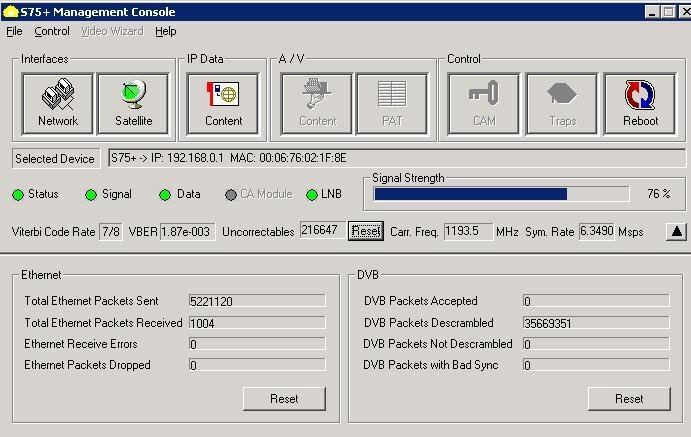

Hi all,
I've have been playing with this system for weeks, finally got the signal to lock, got some weather data, but the error rate is a bit high. Most tuning refers to Signal Quality, but this software has only the signal strength indicator that doesn't help much. Any NOAAPORT user out there? please help me.
Spec:
Dish: 12 foot
Receiver: Novra S75+
OS: FreeBSD
Receiver software: S75+ Console Management (see picture)
Data processing software: nbsp (noaaport dot net)
in the attached picture, the VBER average in 2.0e-3 which is high and occasionally produces Uncorretables. My goal is to get the VBER to 1.0e-4
Thank you.
Regards,
Kevin
signal level is a bit low. usually a data signal requires a real good lnb / lnbf and a perfectly aligned dish.
1) check all coax connections , if possible remove any splitters or connectors.
2) if you haven't made fine tuning adjustments with the dish you should be able to try that to gain signal level. if you have someone that can watch the signal level you can have another person lightly push or pull on the dish left & right and up & down. (there might be a slight delay in signal so give the receiver a few seconds before each move... with the signal comming through to a computer allow a few extra seconds)..... usually this can be done without loosening the dish bolts. if you find a gain adjust the dish accordingly.
3) if none of these help a slight adjustment at the lnb/ lnbf might help gain signal, adjusting slightly in or out (making sure the lnb / lnbf is properly centered).
Thanks Gabshere,
Following your advices I went to the roof. After a few tugs here and there without loosening the bolts, I noticed some improvement in the error rate, it was jumping between 1.0e-4 to 1.0e-7, which is acceptable. After loosening the bolts, a friend of mine tried to turn the dish just a bit, but because the dish was too heavy so he tried very hard and got it moved about 1 degree (a lot more than what we wanted to do.) Fortunately, we accidentally hit the right spot and the error rate dropped to 0!
Just 10 minutes and it's done! We have been spending at least 3 days on the roof but couldn't get the signal anywhere near where it is now. Thanks to you ;)
Now that the signal from the dish to the receiver is good, I still have some errors while processing data. It reports many missing fragments... I think this has to do with my computer isn't fast enough to process all that data, or there are some bugs in the software. I will play with it some more, and post my results here to share with you and others.
Kevin

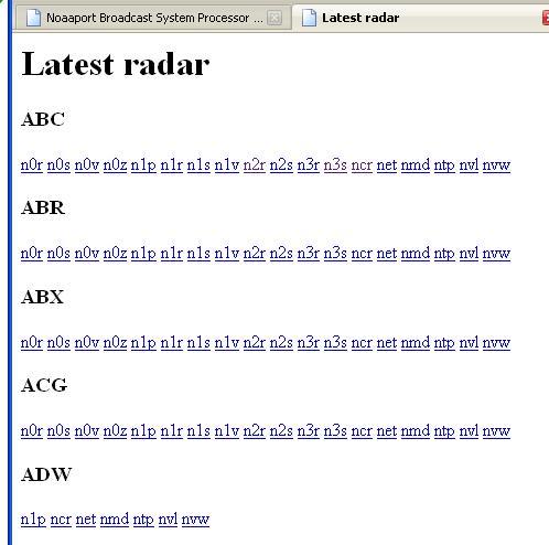

I think it got radar data, it's just that the software isn't process them correctly. Below is the screenshot
After clicking into those files, I got this error message:
Got the error Server Internal Error
while trying to obtain /nbsprad/display_radmap.
nbspradmapl: Error: nbspradmap: couldn't execute "gpmap_gif": no such file or directory child process exited abnormally while executing "exec nbspradmapl -d $outputdir -l $latestname $site $type $nidsdir" (procedure "nbsprad/display_radmap" line 22) invoked from within "nbsprad/display_radmap digatmos/nexrad/nids abc n2r latest radmap" invoked from within "catch $cmd result" invoked from within "DirectRespond $sock $code $result $type" (procedure "DirectDomain" line 29) invoked from within "DirectDomain nbsprad sock13 /display_radmap" ("eval" body line 1) invoked from within "eval $Url(command,$prefix)
[list $sock $suffix]"Tcl Call Trace
5: DocSubstSystemFile sock13 error 500 {nbspradmapl: Error: nbspradmap: couldn't execute "gpmap_gif": no such file or directory child process exited abnormally while executing "exec nbspradmapl -d $outputdir -l $latestname $site $type $nidsdir" (procedure "nbsprad/display_radmap" line 22) invoked from within "nbsprad/display_radmap digatmos/nexrad/nids abc n2r latest radmap" invoked from within "catch $cmd result" invoked from within "DirectRespond $sock $code $result $type" (procedure "DirectDomain" line 29) invoked from within "DirectDomain nbsprad sock13 /display_radmap" ("eval" body line 1) invoked from within "eval $Url(command,$prefix)
[list $sock $suffix]"}
4: Doc_Error sock13 {nbspradmapl: Error: nbspradmap: couldn't execute "gpmap_gif": no such file or directory child process exited abnormally while executing "exec nbspradmapl -d $outputdir -l $latestname $site $type $nidsdir" (procedure "nbsprad/display_radmap" line 22) invoked from within "nbsprad/display_radmap digatmos/nexrad/nids abc n2r latest radmap" invoked from within "catch $cmd result" invoked from within "DirectRespond $sock $code $result $type" (procedure "DirectDomain" line 29) invoked from within "DirectDomain nbsprad sock13 /display_radmap" ("eval" body line 1) invoked from within "eval $Url(command,$prefix)
3: Url_Unwind sock13 {nbspradmapl: Error: nbspradmap: couldn't execute "gpmap_gif": no such file or directory child process exited abnormally while executing "exec nbspradmapl -d $outputdir -l $latestname $site $type $nidsdir" (procedure "nbsprad/display_radmap" line 22) invoked from within "nbsprad/display_radmap digatmos/nexrad/nids abc n2r latest radmap" invoked from within "catch $cmd result" invoked from within "DirectRespond $sock $code $result $type" (procedure "DirectDomain" line 29) invoked from within "DirectDomain nbsprad sock13 /display_radmap" ("eval" body line 1) invoked from within "eval $Url(command,$prefix)
[list $sock $suffix]"} {CHILDSTATUS 95925 1}
2: Url_Dispatch sock13
1: HttpdRead sock13

Jose,
Thank you. Yes, after further reading I found out that it needs Gempak which cost a lot of money. I think I can manage without the radar images.
I'm in the process of learning all the data format that I received.
Thank you all for your help.
Kevin
Kevin
Gempak is free from Unidata. You may need to compile it yourself.
But if you use FreeBSD, I have a free package that you can
install with pkg_add in the usual way.
Jose
Kevin
I just double checked, and the gempak package is available in the
noaaport site in the software section (under packages->optional packages)
for FreeBSD 7.2.
Jose
