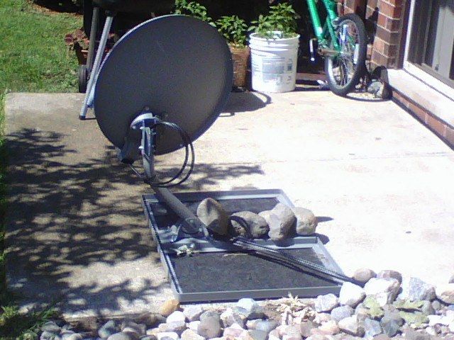

yes I have my 6ft dish on a NPRM using cinder blocks. unless you are in very windy location, you should be ok
http://www.satelliteguys.us/free-air-fta-discussion/228237-6-foot-dish-install-17.html#post2365582

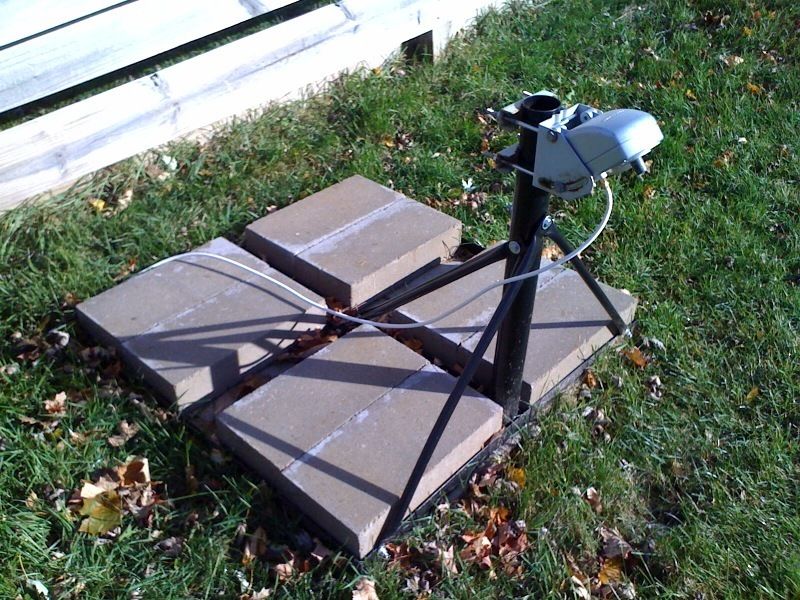

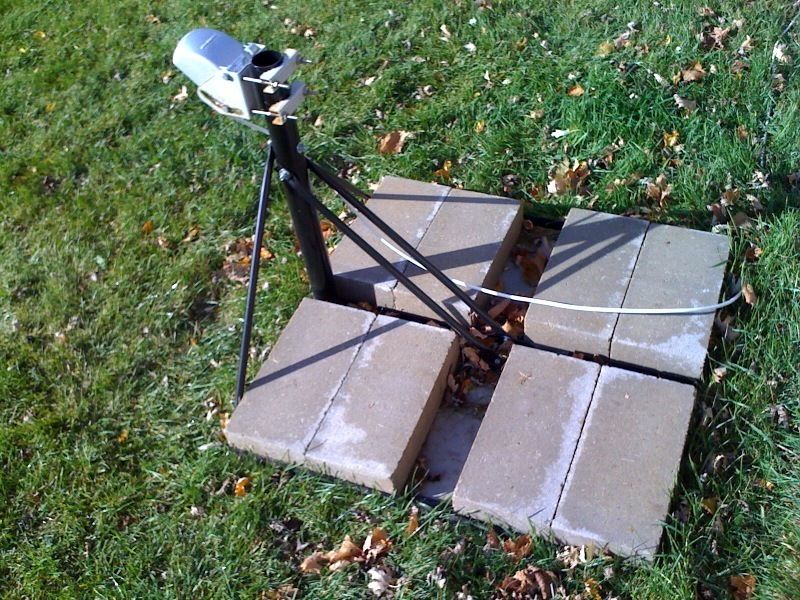

In the past, I've noted that several members have put their NPRMs on the ground.
Often using the one that came with the Prodelin 6' offset Ku dish.
I've given some thought to an 8' dish on exactly that same base.
Based on pictures posted, I was thinking about placing the whole thing on some sort of cement blocks, at least at the corners.
That should keep it off the ground and out of the wet.
However, what to put under the NPRM to keep down the grass/weeds, was a question I hadn't gotten to.
I guess one of the tricks is to keep the pole as short as possible, limiting the leverage the wind gets on the dish to tip it over.
That also keeps the dish low to prevent objections from neighbors, so it's a win-win. - :up
