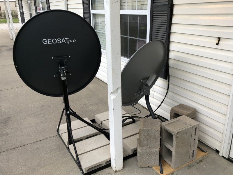

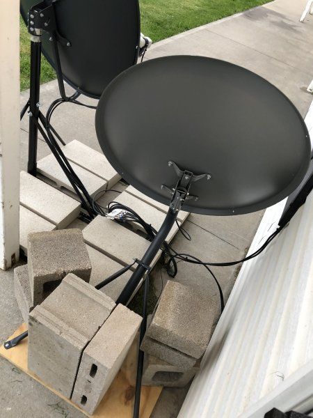

Second dish on non-penetrating mount idea?
$835.00

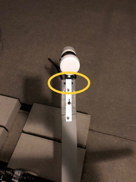

The screw goes into the metal housing between the two coax connectors.
Thanks. I may buy one of those. How does it anchor to the feed arm? The pictures on the seller's Ebay listing don't show any screw holes. Could you take some pictures of yours?
Sorry for the late reply. The coax gets fed through the arm
Reactions: comfortably_numb
Thanks for the pics. Mine looks slightly different (there are two holes and none in the middle)

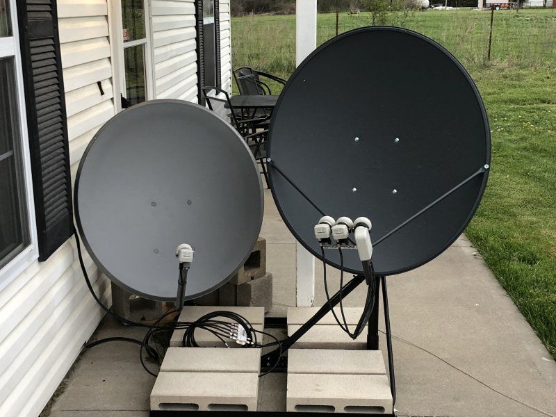

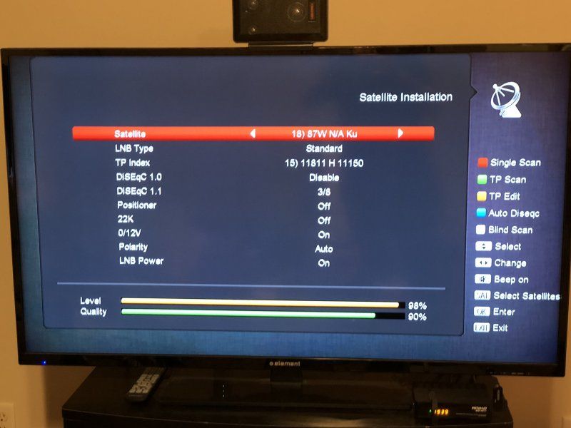

WOW! I never was able to get more than 65% on LPB using the Wineguard!
Must be my location?
I find that the GeoSat SL1PLL LNB's make a big difference too. That's all I use.
