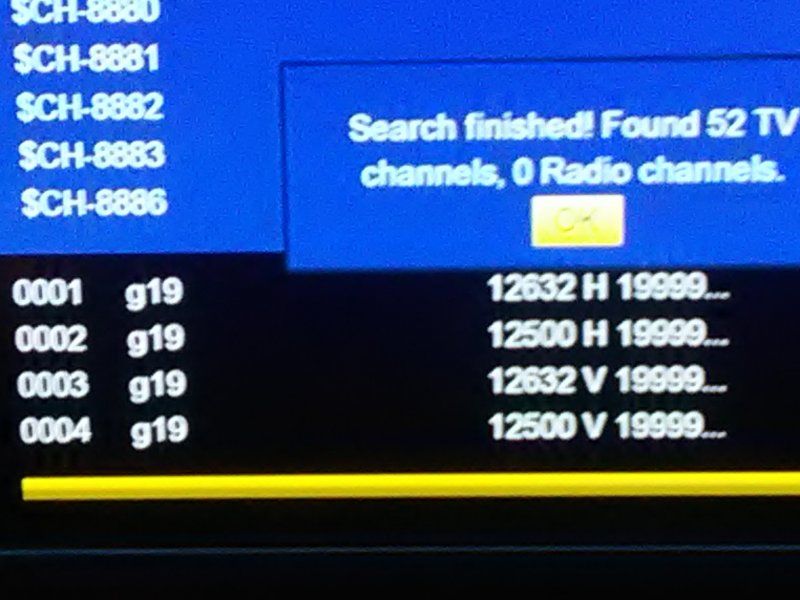

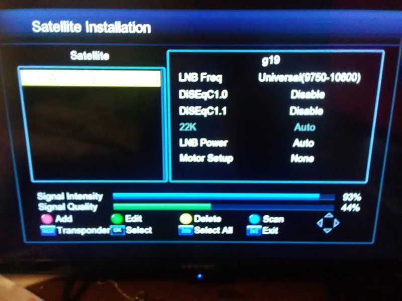

G19, 97w , universal 9750-10600, 22k auto, intensity 93%,quality 45% , blind scan brings 12632 h 19999 12632 v 19999 12500 v 19999 12500 h 19999. Thinking those are 110w.

You aren't pointed at 97W, there aren't 700 channels there even if you get all 20-some transponders.
The receiver doesn't care what satellite you have selected if you do a blind scan, it'll add whatever it finds to its list for that satellite. Selecting a different satellite isn't going to make any difference unless you have a motorized dish or multiple dishes/LNBs on a switch.
Looks like you are aimed at 110W, a DISH Network bird.
I think he is aimed at 91°W . Most everything at 110°W is Turbo 8PSK. I don't think he would scan hundreds of $ channels from 110w because of that.
The channel numbers in the screenshot posted by Dfwratt match the content of 110W Tp 20 spot 21 - Local channels from Texas and other southern states. If you look on Lyngsat the PIDs match those channel numbers .
