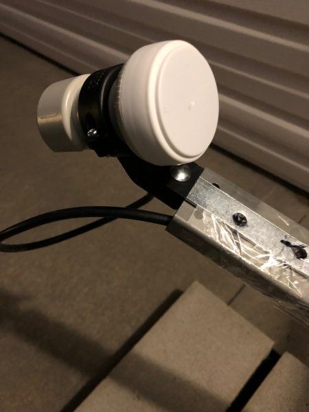

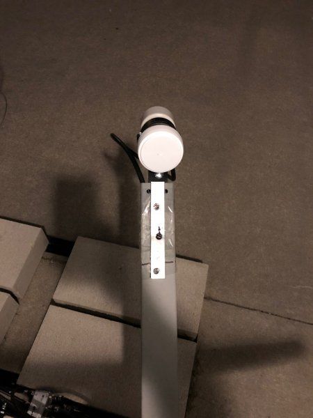

So based on the comments in this thread, today I went to the hardware store and bought a metal bracket. I wanted to try and adjust the LNB to the height of the previous Dish Network LNB's on the 1000.2. Unfortunately, after doing this, I got no signal at all.
I decided to use the bracket to go back to the way the LNB was mounted before, this time centering it on the feed arm. I duct taped it on temporarily (need to buy more nuts and bolts and drill holes into the arm).
Now I'm getting 71% signal quality on the CNN feeds and about 45% on the MTA channels.
Not sure why, but for some reason the LNB just works for me when mounted this way :)
I know the reason! When you change position of the LNB you forget to change position of the antenna. The proper way ahead must be: Install LNB in such a way that it's Phase center is co-located with antenna's Focal point and LNB is pointed to the right place on the surface of the dish. And then move antenna azimuth/elevation get maximum signal. Do not forget to adjust skew of the LNB if you are getting linearly-polarized signals.
Trust me I did move the dish! I tried and tried and got no signal anywhere. Then moved the LNB back to the position it's in now and it works great :what
