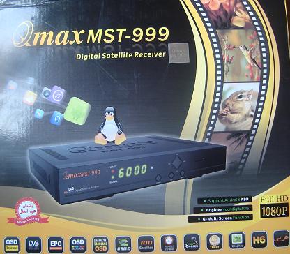

Hello,
I am new over here and I hope I can learn from all of you. It seems, there is a lot of members over here has a good experience...
I was in Middle East a while ago and I brought a receiver from over there it's called Qmax MST-999 H6
I just want to know how I can add the American satellites to it, although it's full of satellites pre-loaded but non are from here.
Also can I use it with Drirectv dish and LNB?
Thanks in advance... :)
Welcome to SatelliteGuys!
Most receivers allow the user to delete and add satellites via the install menus. The manual input will be tedious if adding many satellites, but easy if only one or a few. The product distributor may offer a PC based editor that edits and loads new satellite lists. I couldn't find the chipset listed for the H6, but it is likely a common chipset and might be compatible with satellite lists provided for a similar North American receiver.
DirecTV LNBFs are not compatible (circular polarity and higher frequency) and usually the dishes are undersized for the weaker power FTA satellites. Some hobbyists adapt the larger DirecTV dishes with linear FSS LNBFs, but it takes patience and a little knowledge.
Reactions: Nicegypt

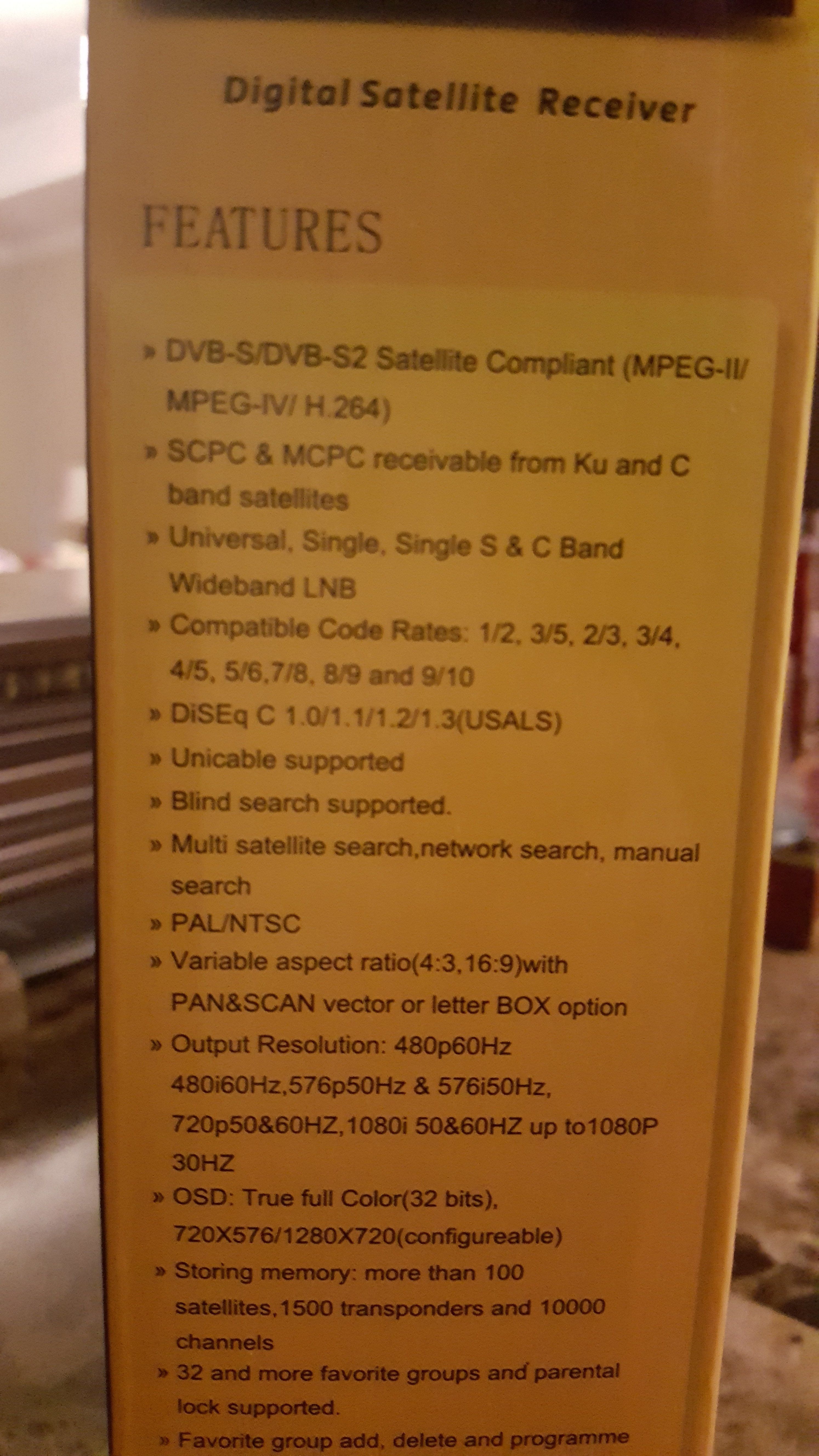

I cant see the specs on it since every site I google is in a foreign language...but on the pic you posted it looks like it just does DVB?
If so there is a lot of stuff you will miss out as DVB-S2 is what alot of channels are

Anyway I couldn't find out the chip-set on that receiver either, but did find that it is DVB-S2.

I also couldn't find S2 capabilities with that receiver. Had some major editing to do.
