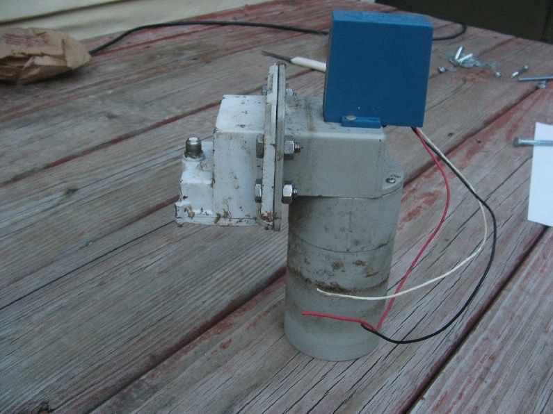

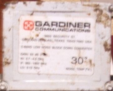

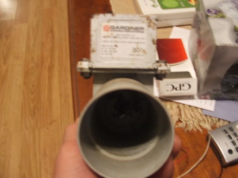

If you do have the Co-rotor, it will have a spot for a C-Band LNB, and opposite there will be a spot for a Ku LNB
not sure what u mean on the lnb so i took a few pics of it
It's a Gardiner communications.
The LNB is the white object that has Gardiner on it.

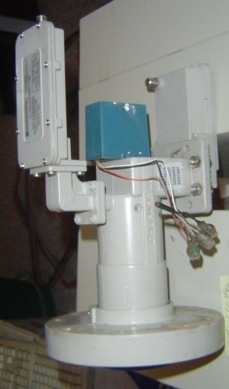

The feed-horn itself is a polarotor which is only capable of handling a C-Band only LNB. The Co-rotor is what you need for both bands. The Co-rotor will have an inlet on the outside of the blue servo motor.
Your Gardiner LNB will probably work ok, but you can see it is a 30 degree Kelvin LNB. It is a little older but should still work. So you will need to purchase a Co-rotor. Sometimes you can get them in a deal with the LNBs thrown in.
Edit: Here is a picture of a co-rotor with LNBs attached:
Hope that helps,
Fred
