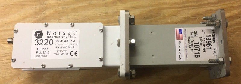

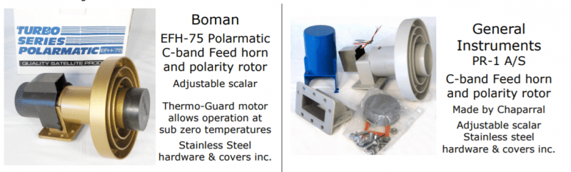

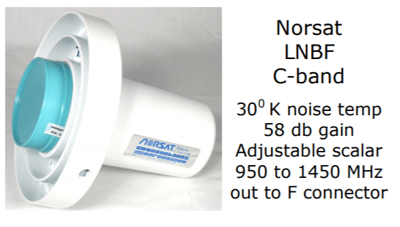

Of these feed horn which will be the best, I suppose that one of these and a norsat 3220 and Microwave Noise Filter is better than titanium to filter interference,
since I have a titanium wimax I worked for 3 months but again I lost the signal in the whole arc
since I have a titanium wimax I worked for 3 months but again I lost the signal in the whole arcView attachment 136282 View attachment 136283
I wouldn't make that bet myself. The Titanium PLL LNBF is very good. There are a lot of reasons you could lose signal on the whole arc and the LNBF is only one of them, and it is less likely than bad connections, bad switch, bad pointing, and general human error. Having a spare LNB and a meter will help answer that.
I wouldn't dissuade someone from buying a different gadget, but not before determining the problem.

If choosing from the two above feeds, I would go with the tried and true, Chaparral.
