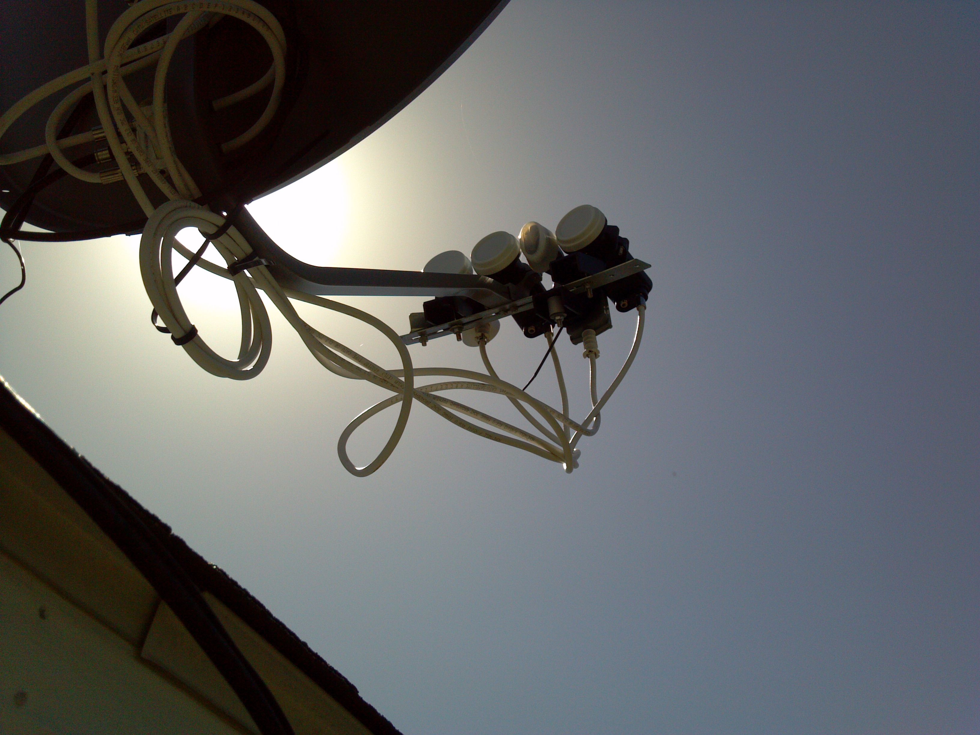

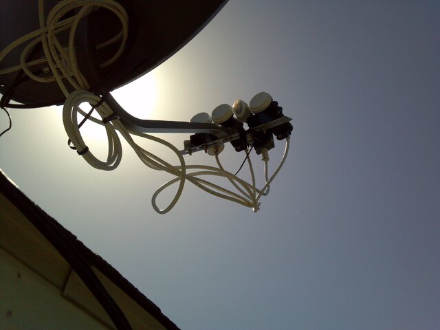

Now have 87w 91w 97w and 103w on one 76cm dish. Enjoying the hobby
4sakntaln
Active SatelliteGuys Member
Jul 18, 2007
19
2
Using the winegard ds2076 I've got these 4 sats kind of 5 really. The funky p170ku+ from Eagle aspen is picking up 91w and the trece channel from 93...Kind of odd. I've installed these during cloudy days. Once even while raining.
I'm just tired of everyone saying to everyone else who is starting out in FTA that their dish is too small. I've been told that repeatedly. But I'm having fun and think I'm doing it well.
But just in case anyone is looking to get rid of a 39inch dish and or a motor I'm listening!
On my stb though, it has two diseqc spots. one does four way. One does 16 way...So will it work with the 8x1 or where do I find a cheap 16x1 or 2 or 3???
wsi lnbs x2
eagle aspen p170ku+
Amiko premium L104
X2 Premium STB
one ds2076.
One no name diseqc 4x1 switch

I use both, 4 x 1 and 8 x 1. I have the three lnbfs on the small dish using the 4 x 1 with the output going into one of the inputs in the 8 x 1. The larger dish has the other 4 lnbf's feeding into four inputs in the 8 x 1. Then the output from the 8 x 1 goes to the receiver.
This did not work with by Traxis 6000 HD but it did fine with the Amiko Alien 2. My Amiko Nano had some issues with the switching.
