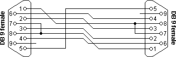

Sounds like a bad serial connection.
Check the cable with and ohm meter and verify that pins 2 and 3 are crossed ... I.E. pin 2 on one end of the cable is crossed and connected to pin3 on the opposite end of the cable.
