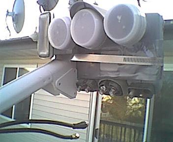

A while back on a DirecPC dish I was able to do 95/91/82. This is when I had my ExpressVu subscription. The DBS LNB in the middle was a spacer.
from closest it was 82/blank/91/95
I was able to get 103 or 101 on the other side. Good signal on all of them :)

Back in the day on my channelmaster (which is about the exact same size of the primestar), I was able to get 119,110, 101, 91, and 82 back in Nor Cal. 101 was strictly for aiming purpose, while the others for my Bell/Dish subs. Being that they were all Circular signals, I'm curious to see what is possible with all linear.
From your photo, looks like 95(linear) is dead middle. +8 deg for the 103 (linear). Theoretically, you should be good another 8 deg the opposite direction (i.e 87 sat). what was the specs on the DirecPC dish (size)? Also, 4 deg seperation is great (91/95).
If its about the same as the primestar, it sounds promising that I could go 91, 97, 103.

thats how those were setup...and I edited the dimensions

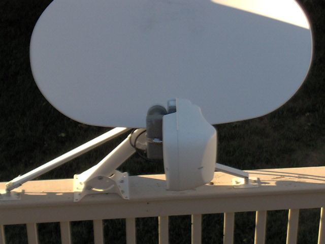

it was 39x23
I am sure that the width helped out on the 4 deg seperation. My understanding is that the wider the dish, the less interference from surrounding sats. The inch height difference shouldn't play a huge play in signal strength.
