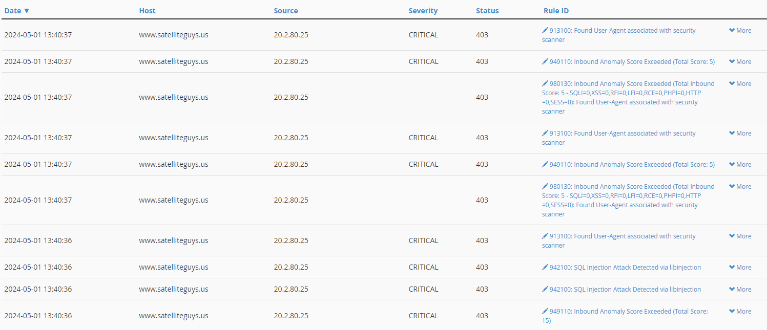

So as everyone may know we have been having strange issues over the past few days...
I have been monitoring the server closely trying to squish everything... and today I have been monitoring the webserver (apache) and php error logs for issues.
It has been clean up until about an hour and a half ago.
Went to do something and came back and pulled up the screens monitoring the system and we went from no errors to OH MY GOD.
Here is what I saw...
Code:
[Wed May 01 12:56:12.256151 2024] [security2:error] [pid 323107:tid 23332770461440] [client 20.2.80.25:59696] [client 20.2.80.25] ModSecurity: Warning. Operator GE matched 5 at TX:inbound_anomaly_score. [file "/etc/apache2/conf.d/modsec_vendor_configs/OWASP3/rules/RESPONSE-980-CORRELATION.conf"] [line "37"] [id "980130"] [msg "Inbound Anomaly Score Exceeded (Total Inbound Score: 15 - SQLI=5,XSS=0,RFI=0,LFI=0,RCE=0,PHPI=5,HTTP=0,SESS=0): SQL Injection Attack Detected via libinjection"][tag "event-correlation"] [hostname "www.satelliteguys.us"] [uri "/xen/whats-new/posts/"] [unique_id "ZjJ0LKJEHT3noqj4-42QIQAAABc"]
[Wed May 01 12:56:12.282728 2024] [security2:error] [pid 323107:tid 23332774663936] [client 20.2.80.25:59697] [client 20.2.80.25] ModSecurity: Warning. Matched phrase "sqlmap" at REQUEST_HEADERS:User-Agent. [file "/etc/apache2/conf.d/modsec_vendor_configs/OWASP3/rules/REQUEST-913-SCANNER-DETECTION.conf"] [line "33"] [id "913100"] [rev "2"] [msg "Found User-Agent associated with security scanner"] [data "Matched Data: sqlmap found within REQUEST_HEADERS:User-Agent: sqlmap/1.8.4.7#dev (https://sqlmap.org)"] [severity "CRITICAL"] [ver "OWASP_CRS/3.0.0"] [maturity "9"] [accuracy "9"] [tag "application-multi"] [tag "language-multi"] [tag "platform-multi"] [tag "attack-reputation-scanner"] [tag "OWASP_CRS/AUTOMATION/SECURITY_SCANNER"] [tag "WASCTC/WASC-21"] [tag "OWASP_TOP_10/A7"] [tag "PCI/6.5.10"] [hostname "www.satelliteguys.us"] [uri "/xen/threads/dish-hopper-and-caller-id.372482/"] [unique_id "ZjJ0LKJEHT3noqj4-42QIgAAABU"]
But THOUSANDS of them. All from the same IP in Hong Kong.
I had to block the IP and I also blocked Hong Kong.
Errors have stopped again. And server load dropped greatly.
