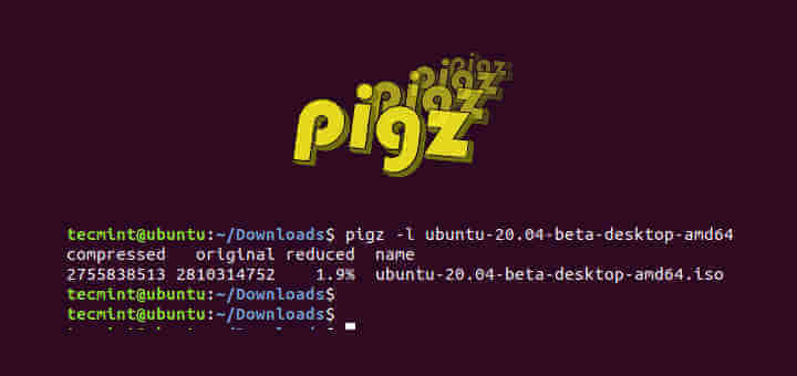

Bobby, I think the issue you may have seen was because of the backups, looks like 3 different backups of the SatelliteGuys database were happening at the same time. Cpanel does one... Xenforo does one and Jetbackup does one.
I just changed the Jetbackup one to 3am. Working on changing the Xenforo one to start at a different time (not midnight) depending on the backup being done it is a resource heavy thing as not only is it dumping a huge database, but then it also gzip's it up for sending it offsite. gzip is a hog. I need to change gzip for pigz which is much better and handles more CPU cores, so you don't even notice when its running. I am adding that to my todo list now. :)
pigz is not a hog...?
