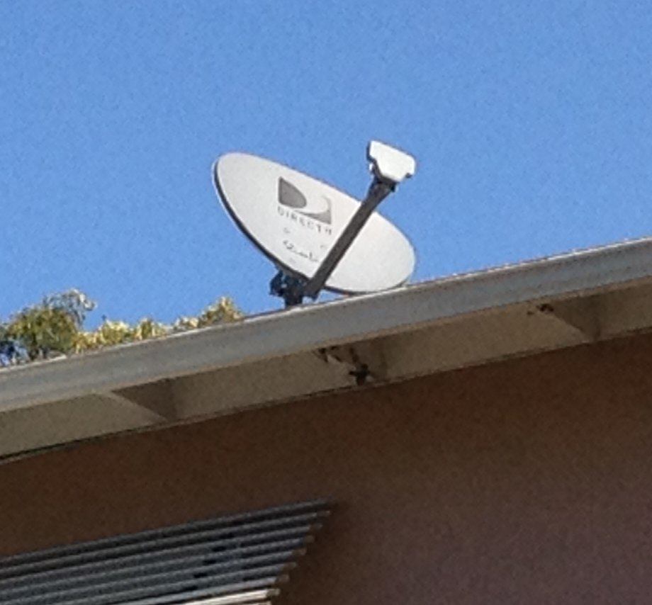

This is a small apartment and the Sat Dish just feeds my apartment.
Yes, I access to all the cabling, but the dish is on the roof and can't access it without getting up there.
Here is a photo of the dish on the roof .........................
Thanks again, you folk are great !
Roy - W8/G4DYR
Can you get a picture that shows the cable/cables coming from the dish?
That means it's a swm setup. You need a power inserter, but find out first if there is already one connected.

The receiver is now working fine, I bought the Power Inserter and reset the system up for a SWM dish and all is good.
