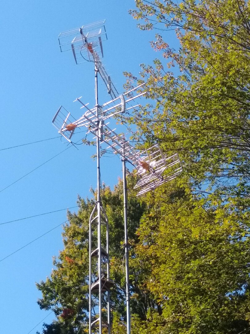

People combine antennas now using a Televes SmartKom, or in some cases a simple splitter used in reverse MIGHT work. Televes SmartKom 531981, "Rotor Killer" Antenna Combiner/Preamp
I have a SmartKom myself. I'll never use a rotor again. In fact my last one was taken down in 1989.
All 3 antennas combined with a SmartKom, All channels available at the same time, all the time:
