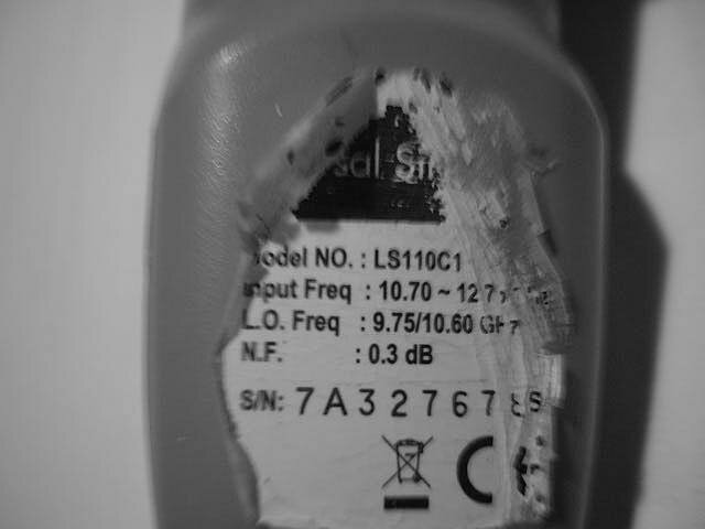

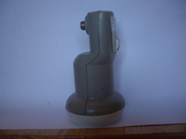

My question --Think the polarity on this LNB is controlled by DC voltage from the receiver. Or,do I need to get another one.

Its a universal LNB and should work just fine
setup on receiver is either Universal 1 (9750/10600) or the "shortcut" is set to standard, LNB LO 10600 and turn 22k on. Since 99% of the satellites across north america dont have the lo band, when you blind scan you'd be wasting time if you set to Universal ;)
(because it would scan the low band which doesnt have anything)
Thanks. Good to know. I'll be ordering a HH motor in the next few days.
