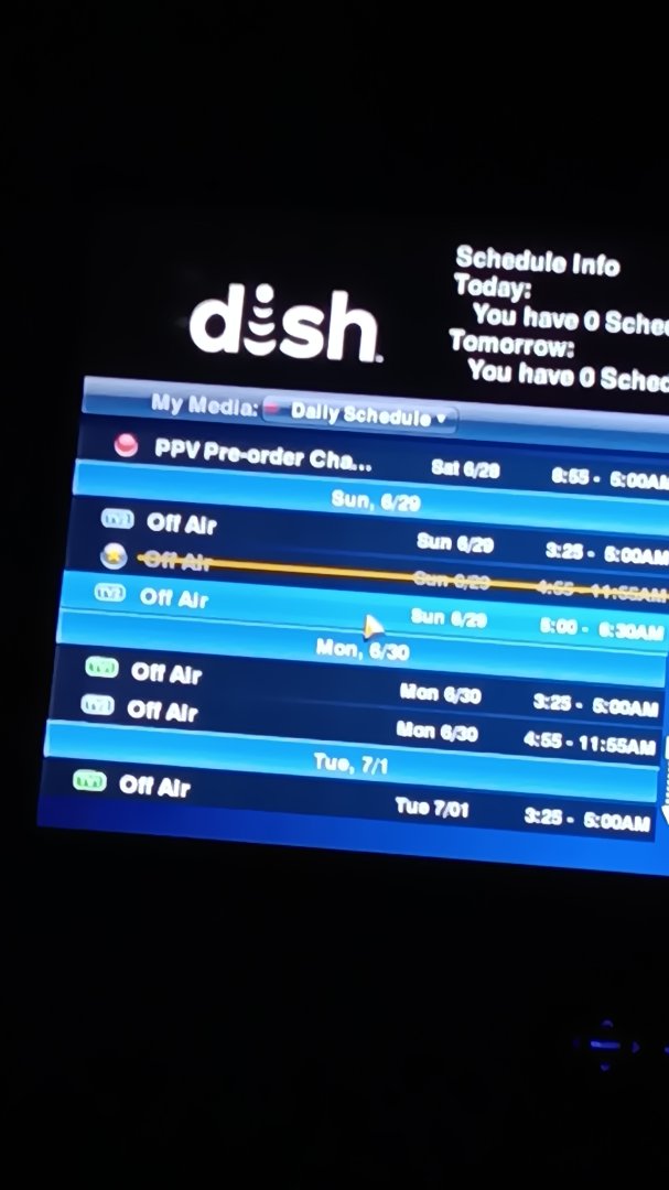

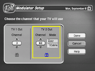

Not sure if you know how to do this but how do I make this TV2 timer TV1
Most installs there was never a good place to mount them, plus too much wiring it was tough to keep things looking neat. Most installs I zip tied them to the back of the dish. Then the customer would unplug the inserter and wonder why the system went down. Also couldn't work on the system with the inserter plugged in, it would zap you if you grabbed a coax.
Here's the image. I want it to record on tv1 only instead of tv2 I don't use tv2.

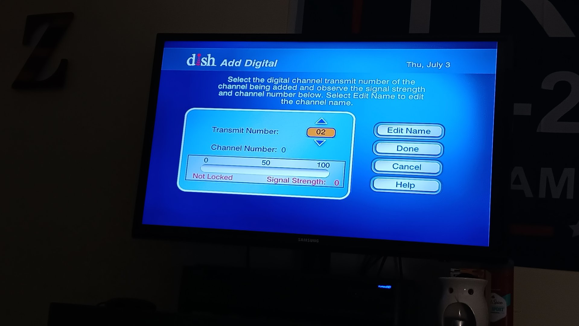

I do happen to have an antenna connected currently. Right now I'm only getting cbs and 4 more stations instead of normal 40
The OTA tuners in these weren't the most sensitive, so don't be surprised if it picks up a lot less channels than your TV's tuner. If you're far from the towers and using an indoor antenna, that's common.
You need to tell the receiver which channels to scan prior to doing your local scan. On the 722 this option is under "HDTV setup". Look for that setting or something similar and under options change the analog type to "offair". Then scan for locals again. All of the other options scan cable frequencies. The reason you are getting one or two channels is because broadcast and cable frequencies are the same for channels 2 through 13.
I have a 612. Not a 722 if that changes any options
